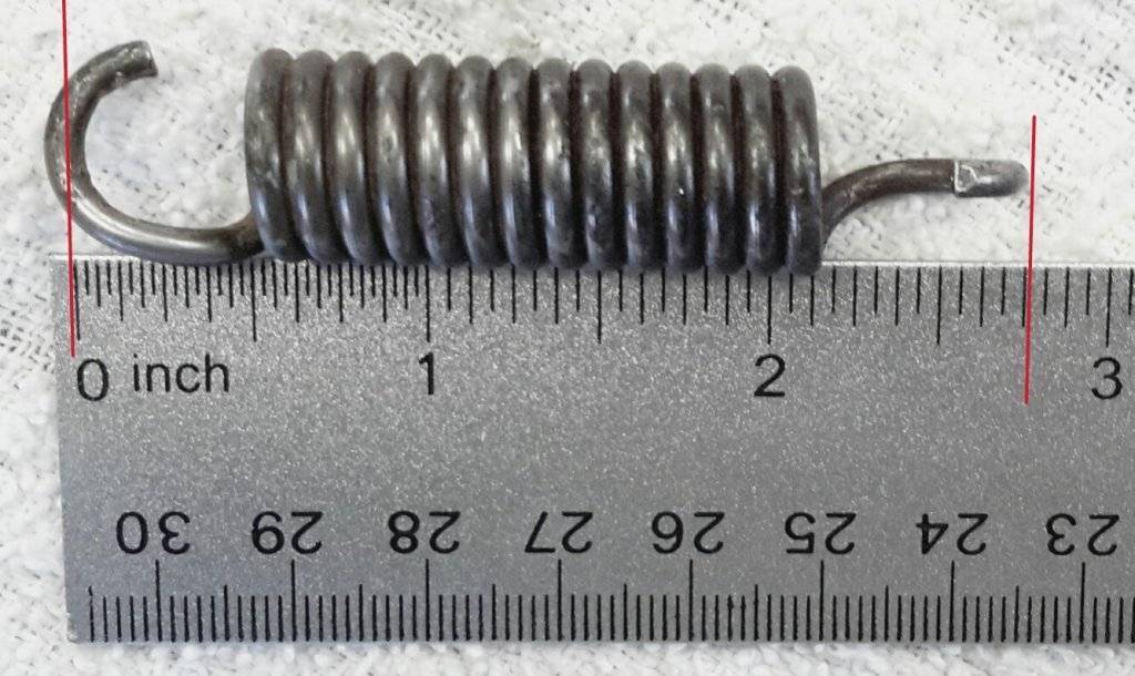

Here's the mystery. The spring itself has plenty of tension but when it's attached theres too much slack as if it's a ¼" too long.
Here's the spring.
The one I have is the same way. It must be that the springs have lost some of the tension from being stretched over time.

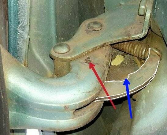

Just to clarify, the roll pin you show goes through a doughnut shaped roller. Two of my Newps still have the roll pin in place but the roller is gone.
My speculation is that over time, through a lack of lubrication, the roller seizes on the roll pin. Eventually, the curved stop rod with the spring wears through the roller until it breaks off, leaving only the roll pin.
So now the stop rod has nothing to rest against, hence the lack of tension on the spring.
Maybe try a mirror on the back side of the hinge and you will see/not see the roller on the roll pin.
I don't think it's possible to replace the roll pin and roller without removing the hinge or fender. (not enough finger space) If you support the door with a jack, you might be able to remove only the lower hinge to repair it.

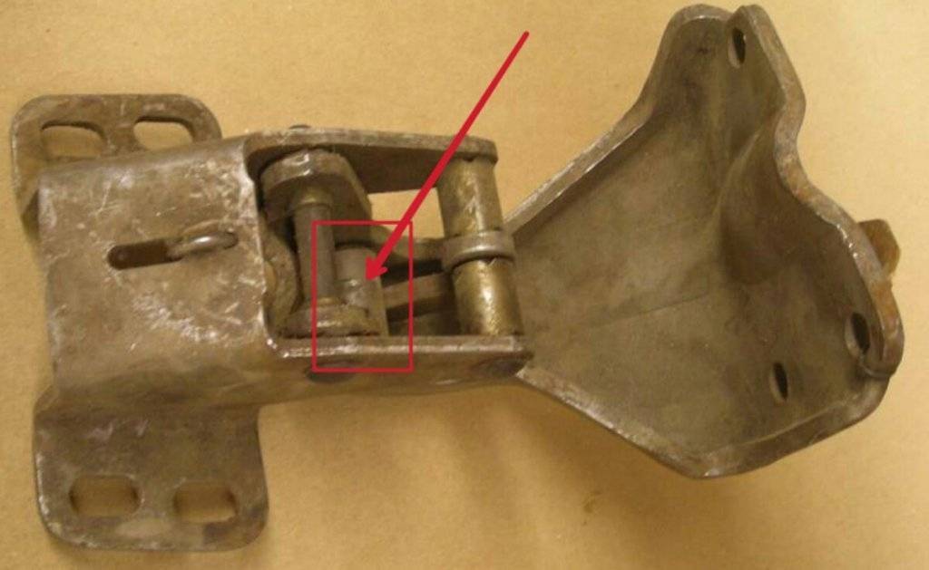

Exactly the info I was looking for.
I was almost certain there should have been a roller. And yes, my roll pin is sheared and there is no roller. With the roller in there, that would push the bracket out enough to take up the slack n the spring I mentioned.
:thankyou:
And here's a picture
