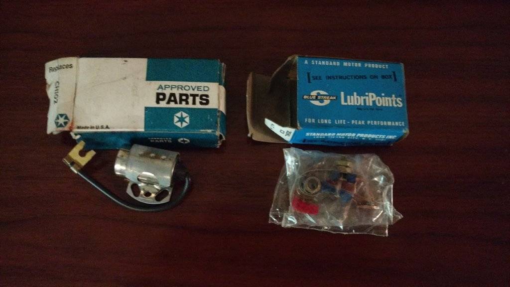

I decided to hold off on the electronic ignition, until I try a NOS condenser from Rip. There would be some great driving this weekend, but have turned my attention on getting my old boat fixed and cleaned up for the 4th of July weekend.
Rip is the man. Waiting for me in a FedEx bag, was not only NOS condenser but the points as well. Thanks Rip
First thank you, thank you Rip, for the NOS points and condenser in exchange for future cold beverages. That was the problem with the ignition.
