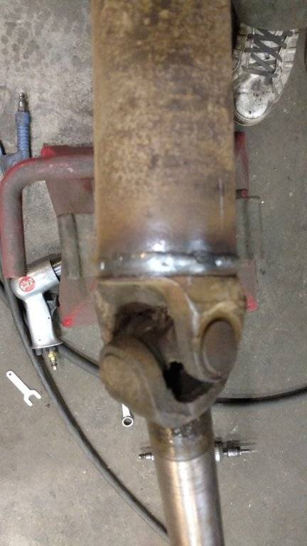

I do not have the correct drive shaft for my Charger so thought I would snap a couple of pictures and let you all follow along as I shorten one from inventory. I know that all the nay sayers will cry foul but I have done this many times and it's not your car. I needed to remove 2 7/8th from this one to fit.
First mark a lengthwise line to index it for reassembly, then make a nice straight cut all the way around just behind the weld, careful not to go to deep wall thickness is maybe .090.

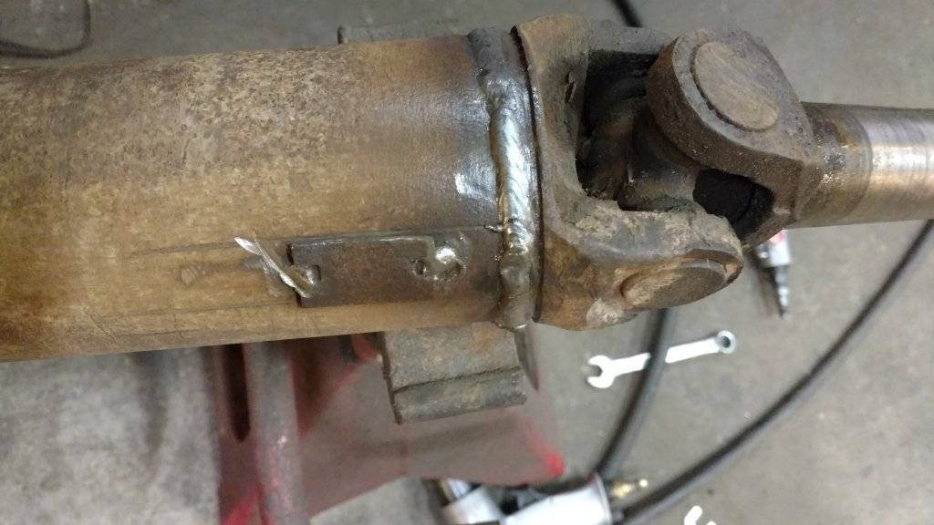

You want to keep the insert piece on the yoke section. I add some longitudinal locating lines and measure how far from cut the weight is for later reattachment. I measure the amount it needs to be shortened from the nice straight cut and tape around measuring multiple times as I tape the circumference.
Bad part of a Mopar driveshaft is the rubber mounted inner tube. Using a small air cut off I cut this back a couple of inches. Using some brake clean and a couple different size screw drivers push the rubber back in between the tubes, if you were to shorten it by more than 5-6 inches I would just remove the tube it's only about a foot long.
Then deburr and bevel both pieces for welding, reinsert the yoke section lining up your longitudinal clocking line and tap it down snug. Whichever side I tap last is the one to tack weld first then tap the other side and tack it.
Then finish weld all the way around and add the weight back using the longitudinal reference lines you made earlier.

Dave, Shouldnt that Get Balanced? I saw a Video once where they shortned it themselves and it Snapped the 727 Tailshaft.
As long as the yokes are timed /indexed properly and the yoke is centered , you did not cut the insert piece off it will ride good. Same as tire balance people get a big head about telling you you need weight on inside, outside, maybe on a front drive wheel but on a zero offset wheel, 3 in 3 out from flange I call BS, a carefully bubble balance will yield same results. The drive shaft has not changed very much at all 2 7/8 less of it, straight cuts and correct index/clocking it is fine.

I think you get into the difference between a static balance and a dynamic (spin) balance.
As I understand it, if the diameter is larger than the length, a static balance will work. If the length is longer (like a driveshaft) than the diameter, then you need to do a dynamic balance.
I've never been a big believer in needing to "spin" balance tires. But... as the tires have gotten wider over the years, nobody does a simple static (bubble) balance anymore.
Chances are good that as long as you index the yokes right (very important!) and put the original balance weight back on, you'll be fine.

A air cut off wheel but I have also used a 4 1/2" angle grinder as long as you can keep it from cutting through the insert so it will center in the tube. I cut the weld just ahead of the tube not down the middle of the bead, you need the end to come out cleanly not have it stuck and fight to get it out. I did a GM one because the slip joint was on the front and I was not sure how it was built on that end. I'm sure it would work the same as long as the amount it is shortened fits in the normally smaller diameter and the weight would stay in small diameter. I guess no reason.

Don't completely disregard balancing... but a drive will prove out if that shaft needs it. The old finish balancers did a good job... the new road force balancers can even make a set of low profiles ride nicer. The key is the if the operator understands what they're doing and gives a crap... two things lacking at your local tire store.
Drive shaft balancing, engine balancing... all have a definite place and need on a car. Close enough will probably work out for most uses... If at the end of the welding the shaft rolled true and the yokes stayed aligned (pics looked good) it should work... if not a balance at a driveline shop should correct it pretty cheap... or a little trial and error with a couple hose clamps...
