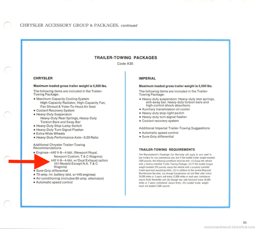

1972 Dealer data book courtesy The 1970 Hamtramck Registry - 1972 Chrysler Dealership Data Book - Standard & Optional Equipment

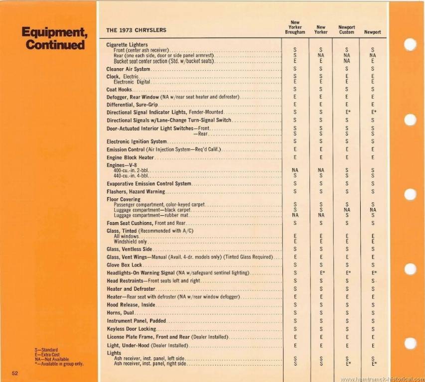

1973 Dealership data book from the same source. Nothing stated here about dual exhaust.
The 225hp 440 and 245hp 440 are much more than an exhaust. It is a different carburetor, different camshaft and the HP exhaust manifolds, in addition to dual exhaust.
