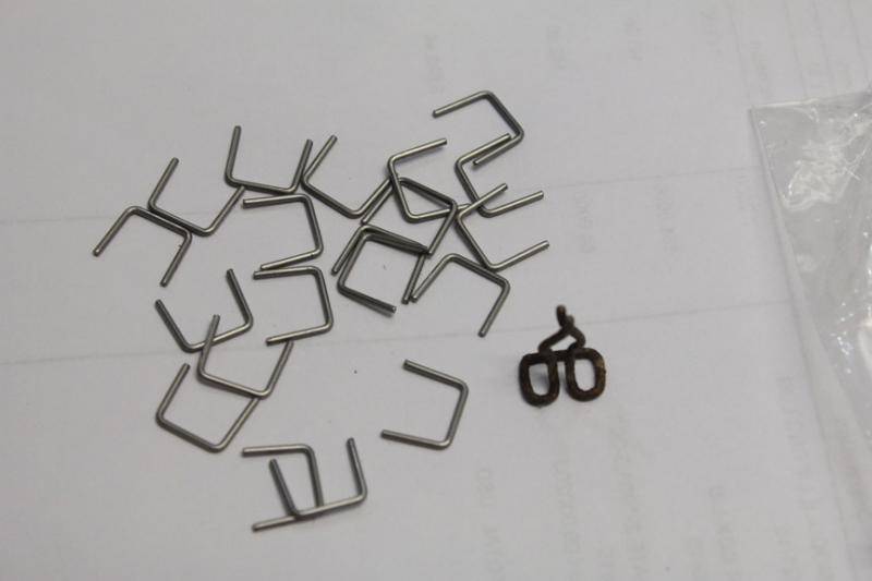

I ordered A-arm dust shields from Vans Auto for my 68 New Yorker. The shields look okay, but the clips are completely wrong. See below.
What they sent are the staple looking things. Where can I get the right clips? Unfortunately I've not been able to find the right clip.

I shouldn't have cried wolf so quick. I found the clips on Year One.

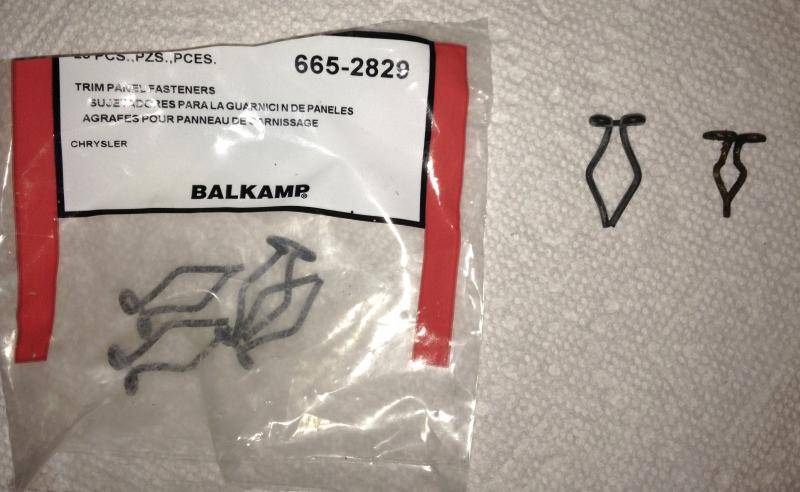

I purchased a bag of 25 at NAPA for under $6.00
I was just at my local NAPA tonight. The closest thing they had would've torn the holes in the shields because of how large they were. Do you have a part #?

665-2829 BALKAMP trim panel fasteners the heads are nearly the same size , but the legs are a bit longer....they worked fine for me - with no rips! new clip on the left / old clip on the right !!IMG_5663.jpg

A bit cheaper... not quite the same (but will work just fine) and not stainless.
