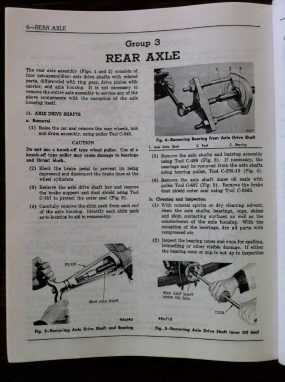

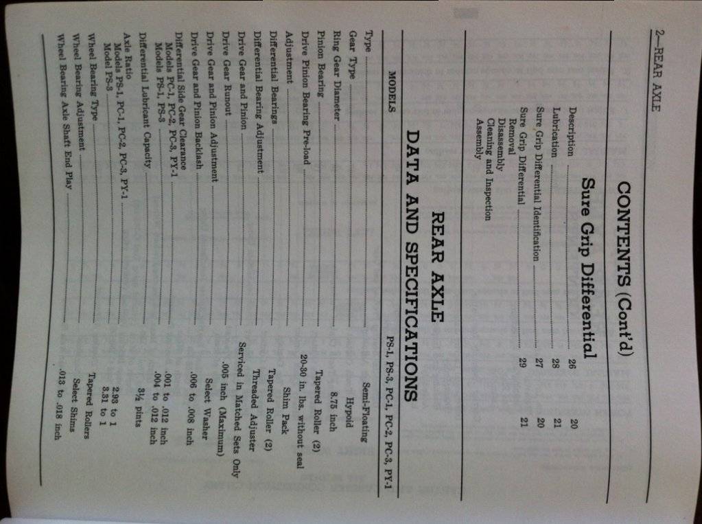

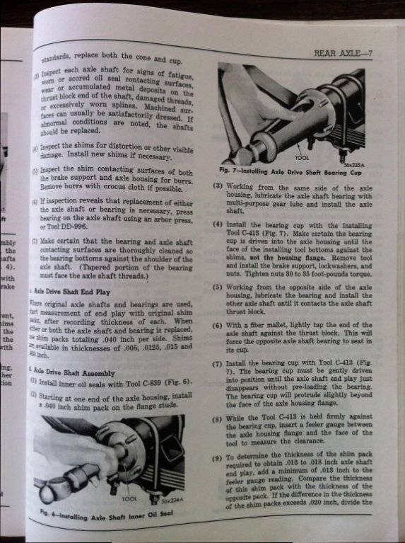

    Some photo's from an early '60's service manual... IMG_1540 (Large).JPG IMG_1541 (Large).JPG IMG_1543 (Large).JPG IMG_1544 (Large).JPG
