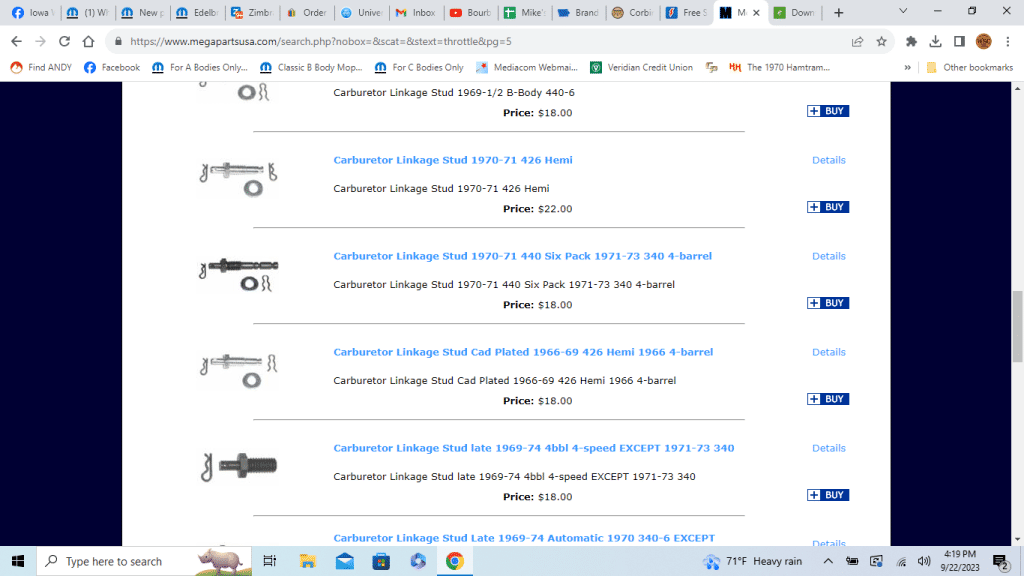

You may need a linkage studs. Lots of different applications.
You're making a GOOD move! I'm delighted w my 1405! I use the old 2 bbl kickdown linkage that came on my 68 Newport with the adapter shown above and a stud off one of my carbs. I got some OEM springs for this, and it all plays VERY nice with engine and tranny. I love the 1405, and spent a few extra pence on a good choke cable. Gertrude fires right up, cold or hot, rain or shine.
