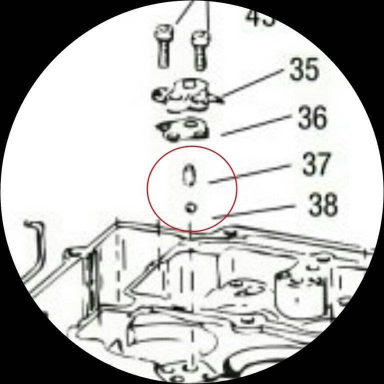

I don't see a spring.
Thanks Stan, I have those diagrams. I'm sure the correct spring could take the place of the weight.
Now I'm getting the concept.
It's a spring and a ball OR a weight and a ball.
And you can make adjustments by changing the ball and/or the spring/weight.
And a spring would be an earlier design?
Also read somewhere that Herb McCandless said to just throw away the weight/spring altogether.
i had type 1 / type A in that pic ^^ the squared off niblet and ball bearing.
commando i dunno which came first, the spring or the weight :)

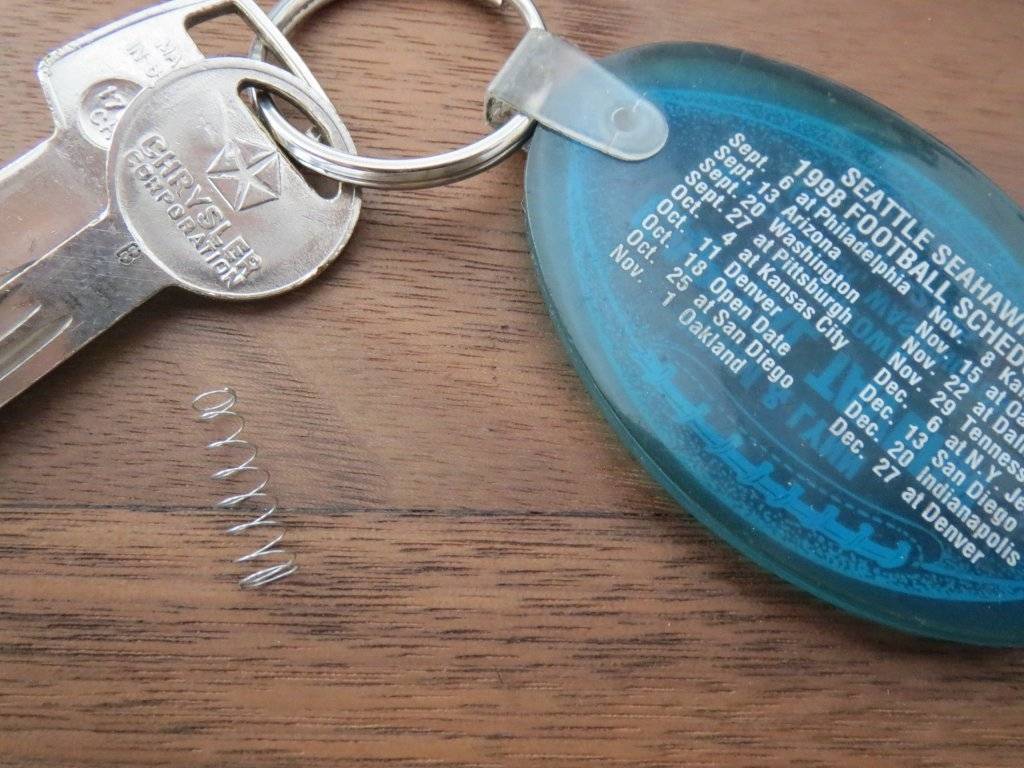

Everybody can remove their springs and weights from on top of your balls in these carbs, Herb was right! Now that I think about it I do remember taking this same advice a while back and got rid of the one in the 1406. Now that the spring is out of the 1411 it has shown a marked improvement with more steady power all the way to cruising speed. Between that and drilling out the nozzles it feels like a completely different carb.:thumbsup:
Mighty fine! I was very skeptical regarding Herb's advice.
This is interesting. I bought a used 1406 a while ago (I'm cheap like that) and I noticed the spring was missing... So I put it back together with the spring.
