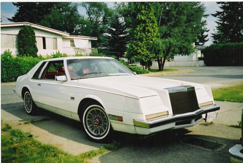

i have an 81 imp with efi n want to convert to carb, can anyone help me with what needs to be done? tks
