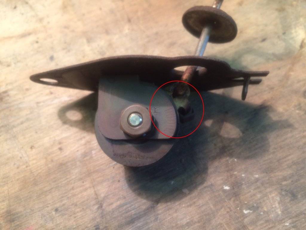

As the choke thermostatic spring ages, it gets "tighter", which means it needs more heat to relax. When you remove the thermostat from the manifold, you'll see the thermostatic coil, held in place with a lock nut, plus a plate with an index mark on it, which lays on top of a scale of sorts, with "L" and "R" (lean and rich, respectively) on it.
I usually start with going 1 notch leaner than the FSM spec. Loosen the lock nut and rotate the R/L scale one notch leaner than where it currently is (or the factory spec). Retighten the lock nut and put the thermostat back into the intake manifold as it should be. Reattach the linkage to the choke plate's linkage.
With the ambient temp (air around the carb, around the engine, outside, metal temp of the engine), when the throttle is manually opened (engine off), the choke plate should just close. An "easy" close rather than a "snap shut" close. From that point, you can manually compress the choke pull-off plunger to see where the opening will be when the engine starts and runs. The "bends" and "V"s in the links make for easy adjustment locations.
Getting the choke thermostat correctly adjusted will determine the basic closing and also the speed with which the choke "comes off". I usually also like to adjust the fast idle speed screw such that as the choke is nearly open, the fast idle speed screw contacts the lowest step on the fast idle cam AND is adjusted to about 50rpm more than the hot base idle speed. As the choke is opened, no real need for really high fast idle speeds with a warming-up engine.

Thanks! Very detailed reply, allot of good information.
As always, thanks for the info. Pulled the choke and seems to have worked. Was at -1, dropped to -2. At least good enough for what I need.
