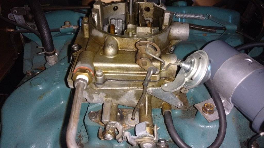

I am tired of the hard cold starts on my 66 300 with a carter AFB. Basically the factory choke thermostat has never worked. I can't seem to find an electronic replacement. I really don't want to pay $150-200 for another factory choke thermostat. Anyone find something that works for them?

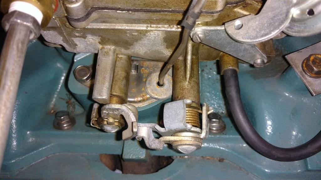

Are you sure the choke is properly adjusted on your carb? I do not have issues with cold start on mine and I have the intake crossovers blocked. I do have to prime the carb before starting if the car has sat more than a few days to make sure there is fuel in the carb bowls. Other than that, it fires right up and holds fast idle for warm up. Have you tested your choke pull off to make sure it is holding vacuum? I would start by adjusting the choke on the carb per the factory manual; step by step. It also looks like someone bent the heck out of your choke rod; mine isn't that straight and we basically have the same setup.
The choke pull-off is new and is functioning the original one wasn't. I can't get the choke thermostat to completely open up the carb, so it would always run partially choked and the 4 barrel would never open up. I hate to think how many times I've pulled the carb to adjust the thermostat never could get it right. Basically it is bypassed right now so the carb is never choked, so a cold start is terrible.
Scott when you get a chance could you post a picture of the choke rod. Maybe that's part of my problem.
The choke pull off might not be adjusted right.
Also, there is an adjustment on the choke itself. If you think it's on too long, set it leaner.
There's also some good info on setting up the choke in the FSM.
Yeah that rod looks to straight. I will look thought my carburetor stuff and see if I can find the one that came off my car before my carburetor change.
Another question what is your intake? Is it stock or an aftermarket? The runners look way too long for a stock 66 440 intake.
After looking at an old intake your runners look about right. Your intake if stock should be 2206000.In the close up of the adjustment you will see index makes.
The Edelbrock kit won't work, you don't have anywhere to mount it. Even if you could use it you still need a choke pull off.
