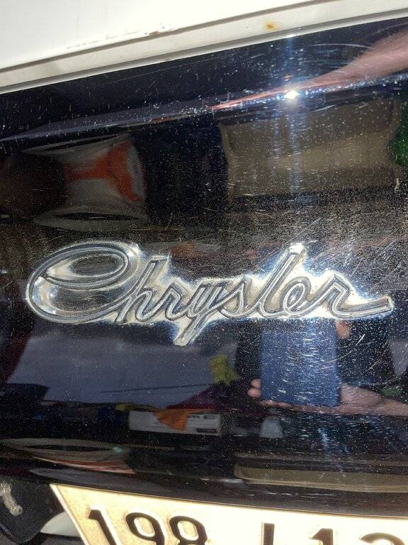

Nov 14, 2021 #1 Shamu70 Member Joined Jan 17, 2016 Messages 192 Reaction score 239 Location Illinois Hi guys, does anyone know if these nameplates on the rear bumper (70 Newport) just pop on & off, or are there fasteners behind.
Nov 14, 2021 #2 D Davea Lux Old Man with a Hat FCBO Gold Member Joined Mar 27, 2017 Messages 9,222 Reaction score 8,574 Location Cornelius Or They usually have trim nuts on the back side. That having been said, about 1970 ma mopar also started using adhesive in the backside on a lot of the scripts, but not usually on the ones attached to chrome plating. Dave
Nov 17, 2021 #3 1970FuryConv Old Man with a Hat Joined Aug 8, 2014 Messages 5,770 Reaction score 5,536 Location Richmond, VA Lower valence is not that bad to remove.
