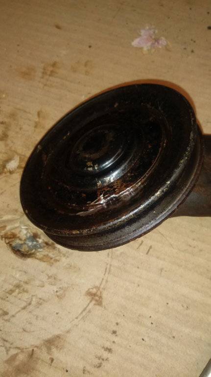

After some research I found out the idler pulley bearing is toast. Ordered a new one from RA and it came in today. New problem/question: I have to use the old bolt and nut cause the new pulley is without those. How do I get the old bolt out ? I thought it was a dustshield and I've tried to hammer it of but ..
I think you probably have the wrong pulley, the OEM style you have does not come apart. www.manciniracing.com has the reproduction pulley, but they are pricey.
Dave
I've seen the one on Mancini and it is indeed pricey. So I thought the one from RA is oke, thinking I could use the old bolt. Mmm, searching for a suitable bolt an option ? Are they available?

The mounting bolt is usually slotted and something of a mopar only item. Some of the York after market A/C systems used the type of pulley you have. The mounting stud has a machined collar that keeps the pulley away from the bracket. You would have to drill out your bracket to make the conversion.

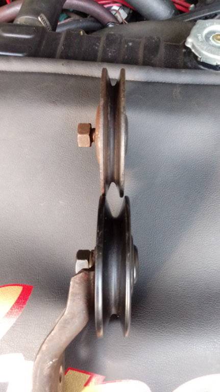

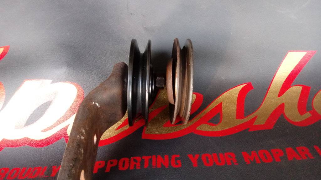

Replaced the idlerpulley at last. As posted before I ordered one from Mancini. First thing I noticed it wasn't a exact reproduction of the OEM one as you can see on the pics. The new one is a bit wider so the belt is deeper now. It works, only thing now is that the adjustment is almost at its end...At least no more screaming anymore :thumbsup:
