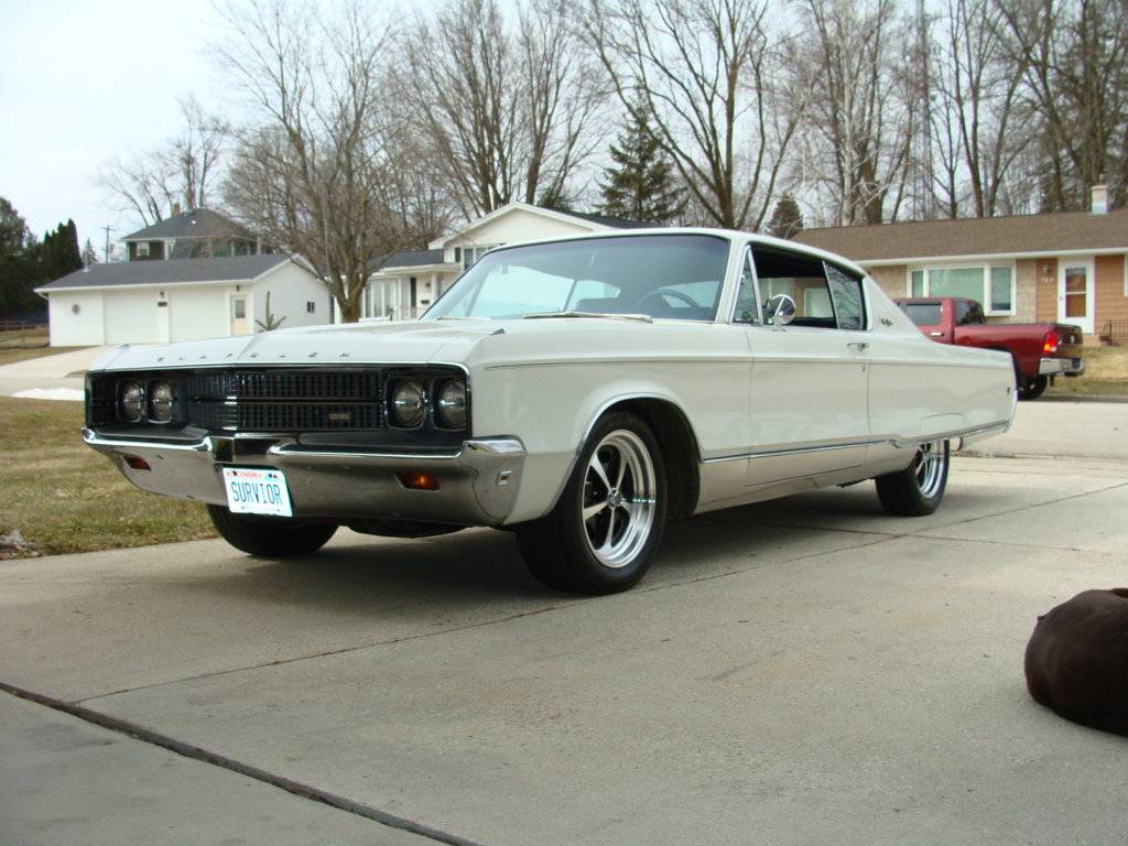

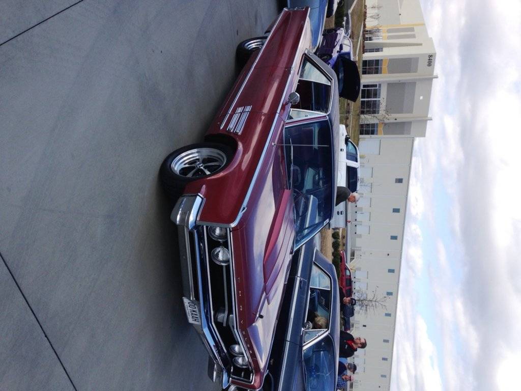

There is a big thread here about wheel and tire fitment on our C's
17 x 8's up front and 17 x 9's out back but the rear springs were moved inboard a little bit. Search this site for photos of the Flyin Whale for more.
