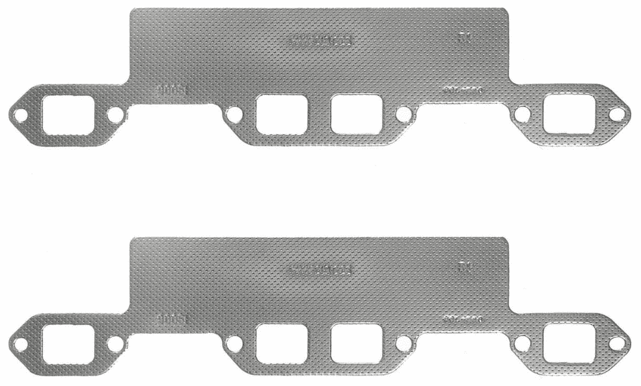

The hipo 375HP TNT motor in my 300 Hurst has those 'performance' factory manifolds so close to the valve covers that every few years they have to be changed just due to the heat which dries out the gaskets, makes them brittle, and then they start to weep. There is an exhaust manifold gasket which has an upper additional 'flap' that sticks up between the manifold and the valve cover that helps preserve both the gasket and also the paint on the valve cover itself. Can't remember who makes it. Looks a little goofy, but solves two problems.

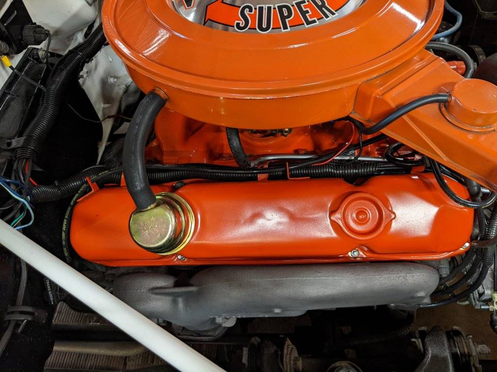

40 inch pounds, correct?
So far the Fel Pro cork valve cover gaskets I used last Fall are doing nicely. The trick is, TORQUE TO SPEC. Don't go OVER, lest you distort them. Don't go under, or the oil will slide out. If ONLY I had no other oil loss issues than that, but alas, valve guides are fukt WAY over....... BUT, my cork gaskets are good! :)
Are you talking about the FEL-PRO MS90425? I have those on my 1971 T-code Monaco. No issue after almost 10k miles.
Those appear to be a VERY SENSIBLE means of blocking heat from rising to where it isn't of any use. I might have to get these next time I take the exhaust loose from the heads....

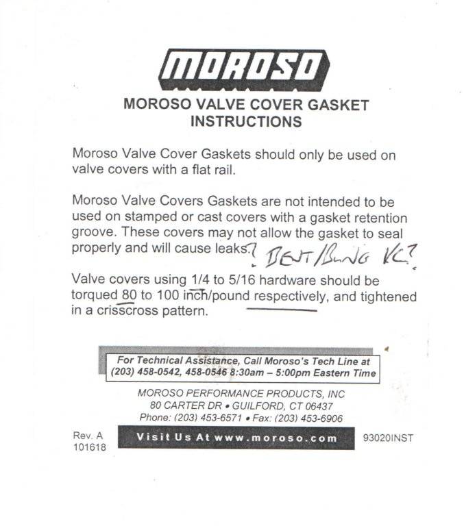

Stock valve covers torqued at 40"lbs. I may have overtorqued, but Moroso generic directions are 80"lbs. Of course, that is all makes and models.
