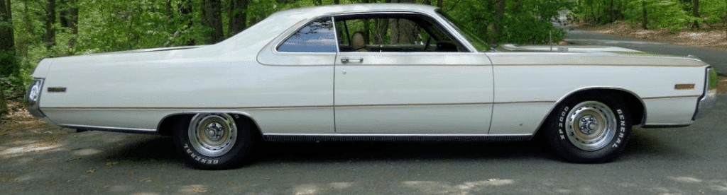

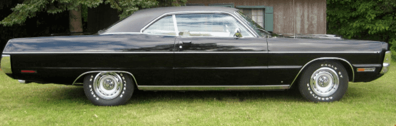

OK done some looking
70 300
70 Fury
lower body line and wheel openings look pretty similar
Not much help but.......
