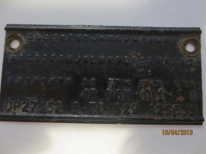

Not sure if this is the right place to post this, but here goes.
Here is the Fender Tag from my 68 Monaco 500.
AX TRM PNT UBS
48 P6X QQ1 8
DP27 62 3 70 329 A25635
Any help decoding?

I think you've decoded the whole tag, there are no options on it. I agree with Dave, lets see the pieces.
It's a big block 4 spd convertible and it ain't green!
It's got plenty of air in addition to the nicely uncluttered engine bay.

Not much help either but based on my fender tag P6 = Bucket seats, 62 = 383 hp 4bbl, DP = Dodge premium trim, 329 is March 29th build date.
It has no upper case, no lower case or no 1 to 10 codes at all, buckets is all its got aside from a primo driveline.
