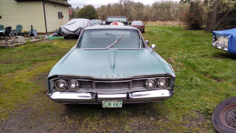

Finally have a C Body!
Welcome! I've got an old MG in the garage that was stuck from sitting 30 years. Popped the head off and worked on the pistons with different oil concoctions, heat, and "firm delicacy" (hammer & wood block). Got it running without further disassembly. You may be able to do the same with your engine. You'll be glad you tried once it's running.
The grill is a little bent so I'd like to replace it eventually. I also need the top fender trim and corner fill piece by the headlight.

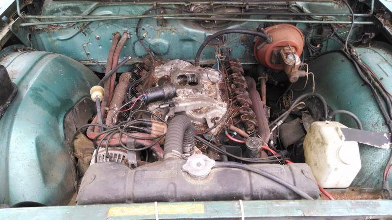

So the valve covers and the carb have been off for a while, that's why the engine is stuck.

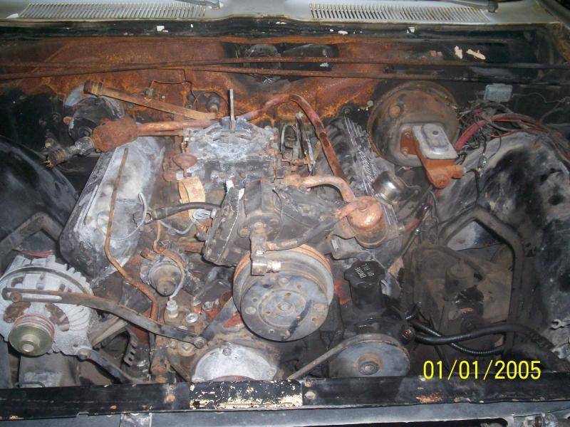

I had almost the same issue when I got my 67 NYer. There was a top end engine fire and the 440 motor wouldn't turn.I cleaned everything up,had to replace the carb,distributor,wires and other misc. parts.I pulled the motor just for the hell of it and replaced all the external gaskets(valve covers,oil pan,front cover).Poured transmission fluid into the spark plug holes and let it sit for a few days.Got the motor to move back and forth about an inch and then she finally broke free after a few more days.001.jpg
Just get a quart or two of cheap transmission fluid.Your only going to drain it out with the oil after you get it to break free.Just try working the engine from the front crankshaft bolt after a day or two.Once it starts to move a little it should break free.If it doesn't move after a week try a little help by using a breaker bar but still work it back and forth.It'll smoke a bit when she first starts up,just burning up some trans fluid left in the cylinders,but should clear up after a few minutes.These motors are tough and as long as there isn't any real internal damage then she should be good. Good Luck!

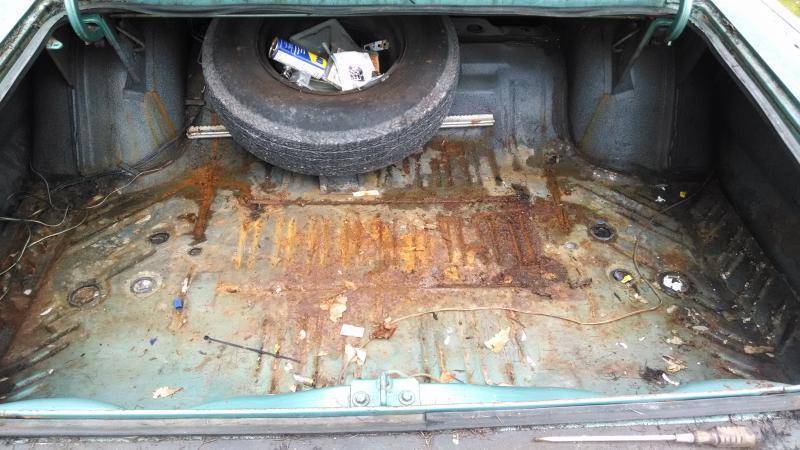

Trunk floor is solid. A little scale that I need to wire wheel off and then treat, but that's it.
A cheap ($20-25) harbor freight needle scaler will take care of that in very short order .. much faster than a wire wheel. Also it doesn't polish the rust it removes it.
Works on paint, undercoating, and rust
Thanks! I'm going out to get one!!
