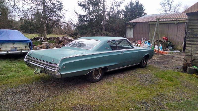

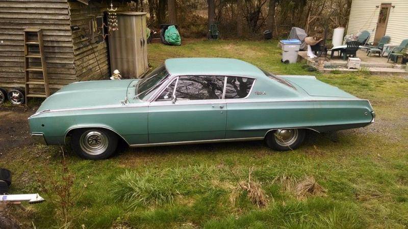

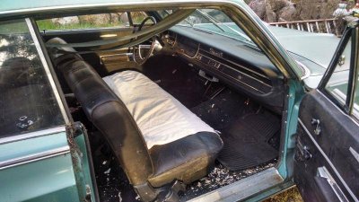

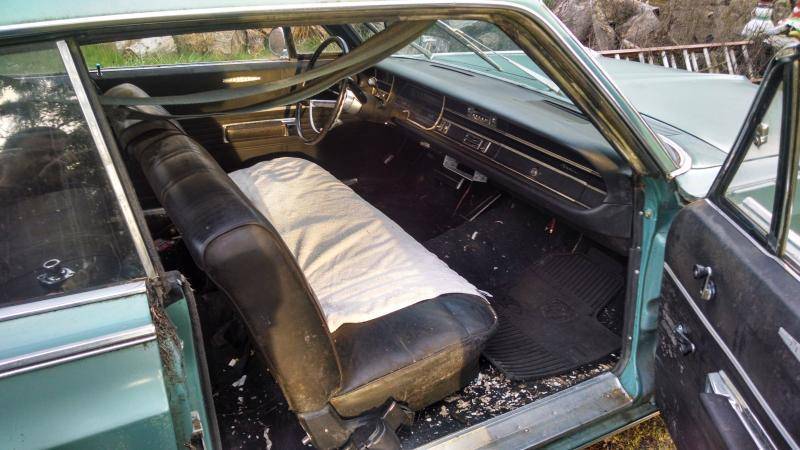

Sealed the deal and got this one home today. A super solid 68 Polara.....and it's a factor big block car. Unfortunately, the 383 is stuck from sitting with no spark plugs. Guess I'm going to have to round up a replacement. Other than that, she need a few trim pieces and a good clean up to be on the road again.
