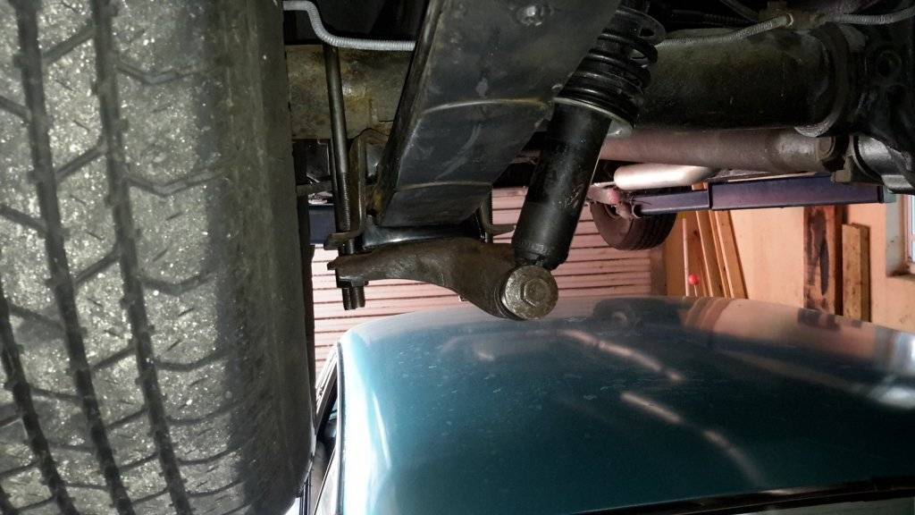

Thank you for this pic Stan! Now I know a little more why the *** on the blumo is higher. Never noticed how far the iso clamp moved the spring away from the axle. With the eliminator kit, the axle is right on top of the spring there for adding another inch or so (it looks like) in ride hieght.
I just took this shot of the shackle on my 66 Sport Fury with a fully loaded trunk ( parts ), hope it helps

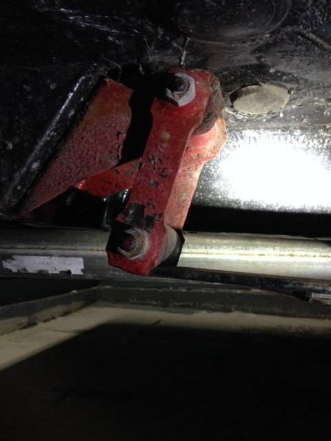

I was going to reply earlier, but wasn't near my computer and wanted to provide you with some pics, but Kenmdale beat me to the punch.
Go back to the pic you posted showing the rear leaf bracket hanger... your photo shows the bracket leg pointing forward when it should be positioned back like Kenmdale's and my photo.
  1. What you need to do is place a jack under the axle where the leafs U-bolts are - do one side at a time.
  2. Get something (crowbar, pipe etc) to wedge on top of where the rear leaf attaches to the silver bracket - you'll need to pivot it to the rear as shown in the photo.
  3. While adding a downward pressure to where the leaf bolts to the two silver brackets, pivot the leaf towards the rear while at the same time slowly raising the jack. It doesn't take much to pivot the leaf back - the jack will do most of the work.
  4. Once the leaf is positioned towards the rear you should be able to attach the shock - then do the other side.
the shackles are now almost perpendicular to the ground leaning forward just a little bit.
I'll give it a bit of road time to see if the settle into the proper position then call on the spring guys that did the springs if they remain forward.
