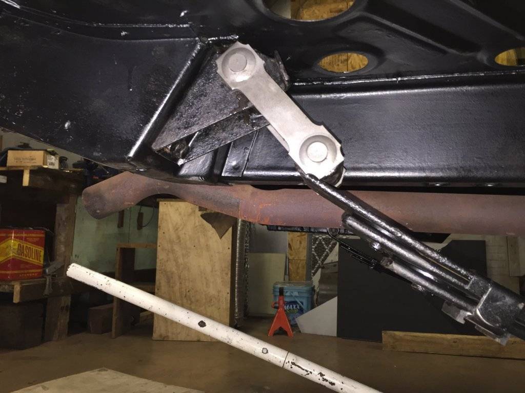

Look at the picture here of the rear shackle, I had to loosen the rear mounting bolts off so I could get the shackle to come together when installing the springs..

If the existing springs were rearced, don't forget the eye-to-eye distance is shortened. Your rear shackle looks a little stretched out to accommodate the shorter length.
Looks to be, that when they re-arched the spring, you lost some over all length of the spring, possibly over arched. Your shackle is now at approx. 45 deg. to the body, when it should be more perpendicular, or more like 90 deg.to the body. I would take a measurement over all length, front mount to rear mount on the spring and compare it with the original factory OAL spec. The suspension geometry has been changed.
Mount the wheels and set the car back on the ground . Don't worry about the shocks for now. Check your ride height.
That rear shackle under load should be more to vertical, with it as it is now you re going to have a lot of strain put on both your front and rear shackle bushes because the spring cannot go through its entire bump range up and down. When the car hits a bump and the springs compresses the shackle with go more vertical but when you bounce the other way, it cant, there is no range of movement and the springs will "tug" at the mounts which will eventually destroy your bushes or worse cause a failure at the mouth points.
Also the rear shackle mount if inverted will only cause your spring to hang down even further making your shock problem even worse.
