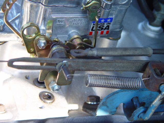

Those of you who have an Eddie carb on a Formal and use the stock accelerator linkage may have a problem with the Eddie not able to get to WOT. You have to drill a hole on the linkage rod about a 1/2" up from the back of the flat rod that hooks to the carb. I'm still in Green Bay and won't be able to correct this until I get home later this weekend or next weekend. The existing hole on the flat rod doesn't allow the Eddie to get to WOT. I'll post a picture when I get it fixed. You can check this by pulling the linkage all the way back and then disconnect it from the carb and pull it back again and you'll see there is a huge difference. Drilling a hole about a 1/2" up on that flat rod changes the fulcrum and allows the carb to open to WOT.

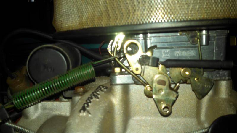

I had this problem on my bro-in-law car, thought I was out of the woods because manual trans(no kickdown linkage) not so. Apparently it is across the board with eddies you will notice a big difference Bob. I will grab a pic of his setup tomarrow.

IMG_20141004_105642_686.jpgI moved it down to this hole redrilled to size because pedal would not pull far enough on top, add in a kickdown linkage and it gets more complicated, like your teacher told you check your work.
