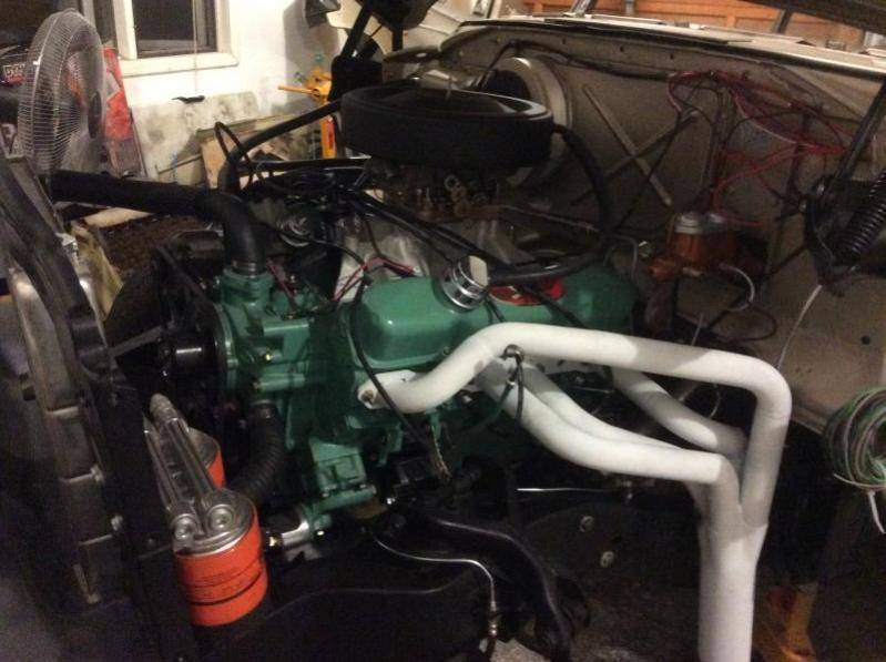

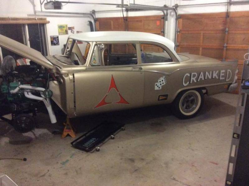

Hello everyone. I am new and think this is correct for my 1955 Dodge Coronet 2dr. I registered in error under the A body forum before I found the description for this one. I have been doing a complete redo on this car for the past 4 yrs. It is my very first build and have done everything on my own, engine, transmission, rear end, body, paint, lettering, wiring and fab'd up my fenderwell headers etc. It was a long, long journey that I hope is almost finished. If lucky I will hit the drag races with it in 3 weeks time. I have put a '68 383 in it, with many hi po mods, a 727 and a new 8 3/4 with 4.11's and posi.
So.... I attempted to turn it over tonight after installing my new B+M shifter. However for some reason the starter gets power only with shifter in 'reverse'!! Not a good thing I would imagine. No power to the starter in any other gears. Sooo, any idea of how I can fix this? I have a 3 prong NSS on the tranny. As well the brake lights do not come on, so would that have anything to do with it?
