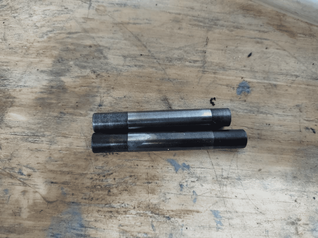

As suggested above, I ordered a push rod from 440 Source. Here is a picture of my original worn out rod next to an un-worn push rod. When the 440 engine in my '66 300 was rebuilt, we used the original push rod which appeared to be in good shape. I think the new cam and the original push rod were not compatible - which I think is why it wore out so quickly.

Remember to treat the the push rod as a lifter, lube well with lifter break in lube. May not play well with old cam. My wagon ate two, it now has an electric pump back by tank.
The manufacturers don't heat treat the pump pushrods as hard as the cam. It's better that the pump pushrod wears instead of the cam lobe.
