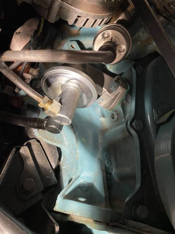

A picture for reference.

Nice pics, thats where Im with mine now. Plug out new rod and pump ready to install. !!
