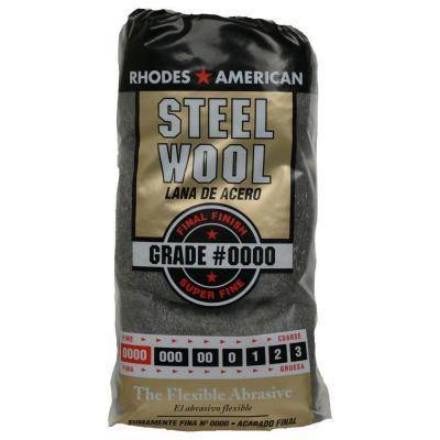

Ouch, steel wool on softer aluminum?
You can't scratch aluminum with cleaner soaked xxx steel wool. It acts as a polish and the brake clean will pull the dirt from the minute pits in the surface. It's espically effective on older grilles and trim.

XXX steel wool and brake cleaner, then polish.

So....Will, you recommend the spray brake cleaner and XXX steel wool. What are you thoughts on using Mother's Mag & Wheel polish with the steel wool? I want to be able to polish up stuff and not wreck it. This should also work on those Mopar Performance aluminum valve covers that are stained up from the antifreeze when the water pump let go a few months ago too.
The XXX steel wool is to fine to cause any damage, espically when used in conjunction with any type of liquid or oil/polish. The brake cleaner just aids in pulling the dirt from the tiny pits & pours found in the surface of older aluminum & stainless trim parts.

The mothers should work fine also, try it on a spare part first and let us know how it works out Bob.
If you use the 0000 steel wool, it will work, did that then Mother's polish on many pieces.
Depending on the supplier, "0000" and "xxx" are the same grade of steel wool, (very fine). For best results It should be used with some type of cleaner/solvent and then apply polish in a conventional way.
