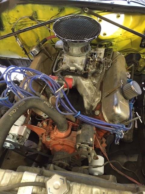

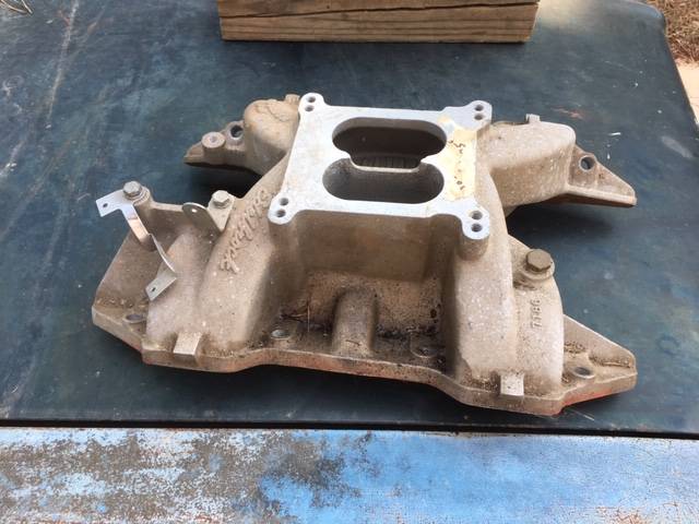

Well I installed the Performer RPM intake & the car runs ragged. Rev it up & it’s missing & popping. I was told the heads in the car had been cut significantly but he didn’t know for sure how much. The flange on the RPM intake is 1/16th thicker than the Torker I took off. Neither has a China wall. So I’m wondering if I need to have the RPM intake cut 1/16th
Did you have trouble getting the bolts to line up?
If not then probably cut enough on the head side of intake.
My 906 heads are cut to allow the use of a paper gasket on each side of the valley pan.
I had trouble with one bolt but it was because I used a paper gasket & it slipped. Maybe I can take the paper gasket out & just use silicone ?
It will be a little work, but I would take it back off and remove the gasket, then set it back on and see what kind of gap there is. You should be able to tell if it's flat or if the heads were milled on a angle. May have to use a feeler gauge the check the gap. Depending on how much would dictate which gasket to use, paper, silicone.
Gotcha. I think I’ll do just that. The Torker was siliconed on

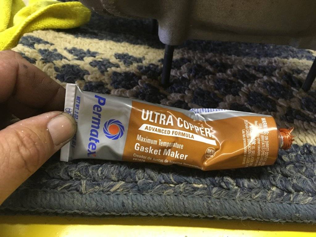

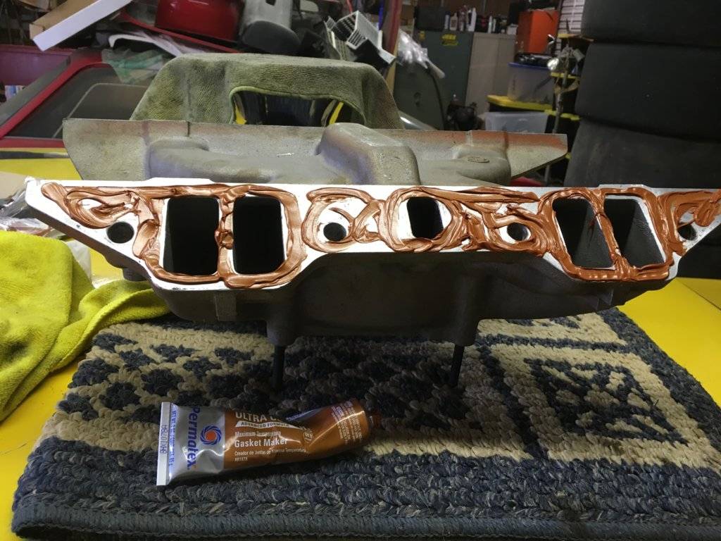

Well after 3 attempts on the Eddy Performer RPM I reinstalled the original Torker. I didn’t put the tall 2 inch spacer back on. Just the carb. It still runs ragged & won’t idle. So I’m at a loss. Sure seems like a vacuum leak but I know I’ve sealed it up correctly. I even tried a different coil. Car starts right up fine just misses & runs rough. Here are pics of the bottom of the intake & the new valley pan with sealer.
