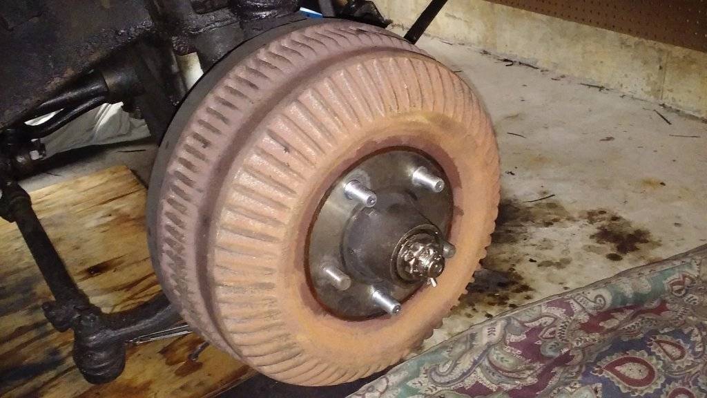

I know this is not the tech forum, but I want to speak specifically to the fuselage crowd...and I have a feeling the answer will either be yes or no, LOL. I'm contemplating the drum to disc brake swap on my 70' Newport. It currently has 11" power drums all the way around. I know these were probably cool way back in 1970, and they still get the job done now ok. However there has been one or two times when I kinda would have liked discs up front....it came too close for comfort. I know there are complete kits out there that can be had to accomplish this, but I just saw nice brand name rotors at Rock Auto for $50 bucks a pop. I figure If I grab these, I could source everything else (calipers, pads, clips, new rubber brake hose..yada yada).
So then the BIG yea or nay question is can I keep my original spindles for the power disc brake set up??

No. Drum spindles are different than disc.
Preferred spindle is a 73 disc but they're getting scarce.
Next in line is the 69-72 disc spindle and with the rotor price for those now reasonable, it opens up a lot more available spindles.

Got it, thanks. I would've loved not to have to replace the spindles, but then that would've made things too easy, of course. At least I know what I need to look for.

I have. Just about every C on here has. Great Option. Cheap, Plenteful. And you use The Drum Spindles
I'm definitely leaning that way. What about the rim size situation....brackets won't clear OEM 14" rims...so this means ya gotta switch to 15" rims front (and rear).

Ford Rotors. But Dodge Calipers....and Gm Brake Hoses.
The Kit making you go with 15 inch Wheels instead of 14, I consider a blessing. 14s on a Cbody are Wrong. You can practicly live in those Wheel wells.
