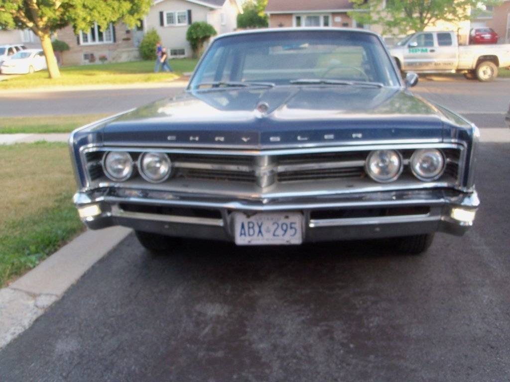

Back on topic...The 300 seedan is officially ready. The l/f flex hose was blocked. After replacement and bleeding the brakes work perfectly--no more pulling into the ditch.
Also did the LED light conversion on the tail/turn signals.
Installed Hella H4 low beams and H1 high beams.
Did a headlamp alignment and discovered why I was suffering from CSS (cant see sh**) driving at night.

All that is left for my first pilgrimage to the Mother of Mopar shows is pack up and gas up.
The car is classified in the 300 non-letter class-where ever that would be in the showfield

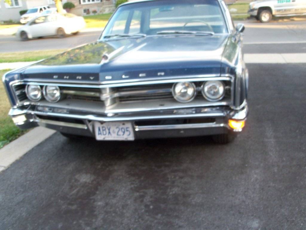

The switchback bulbs are REALLY NEAT!!.
White on park,amber when turn signal activated.
I obviously missed the discussion on these "Switchback" lights please point me in the right direction as that's frickin cool!!

Plug and play or do you need the electronic flasher?
Electronic flasher with external ground wire. On Mopars you have to ull out the spades in the flasher plug and reverese the polarity to match the flasher.Works like a charm.
