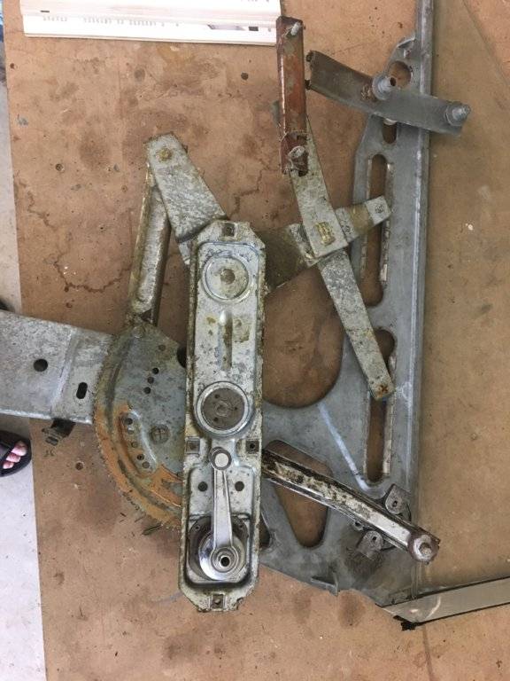

I'll start with the regulator layout pic in case you forgot how it goes together. I'll follow that up with some more photos.
1965 Dodge Monaco rear window regulators
If link doesn’t work do a search.

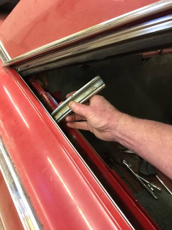

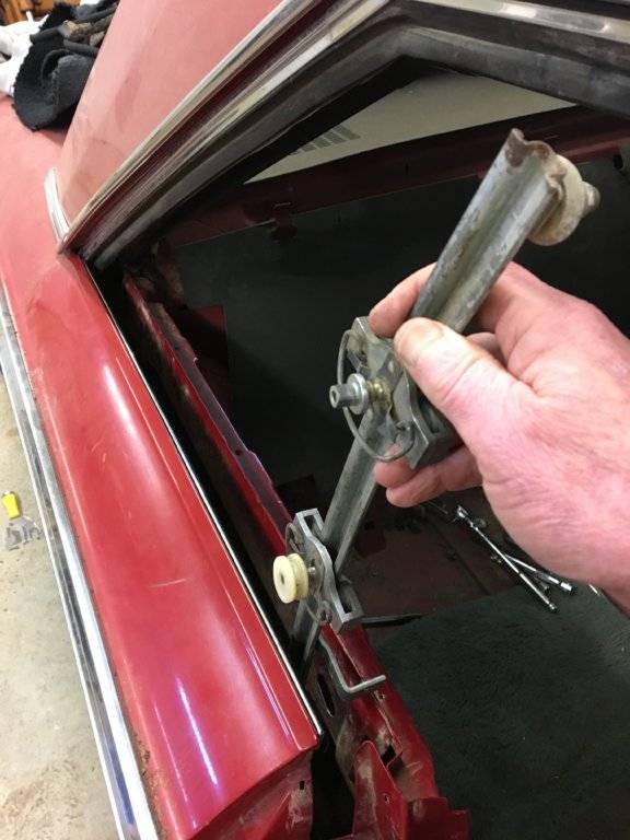

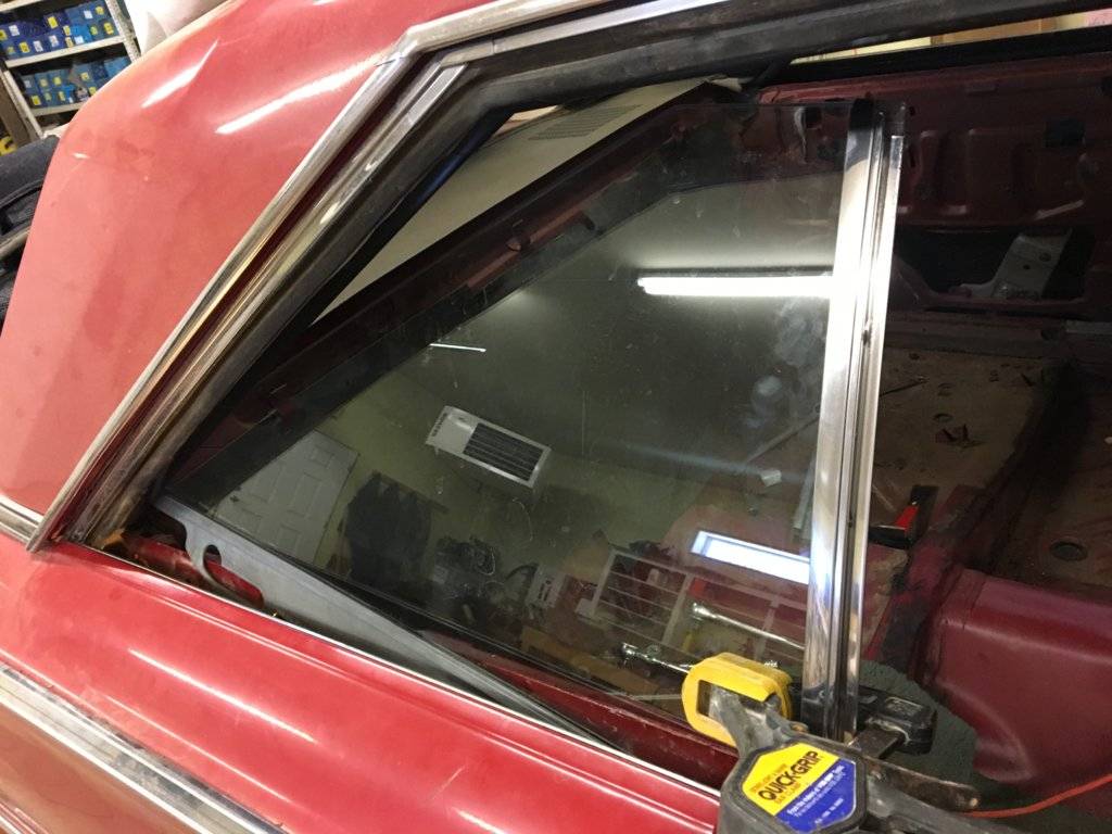

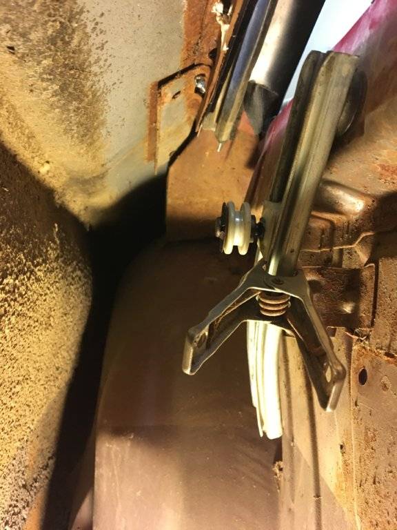

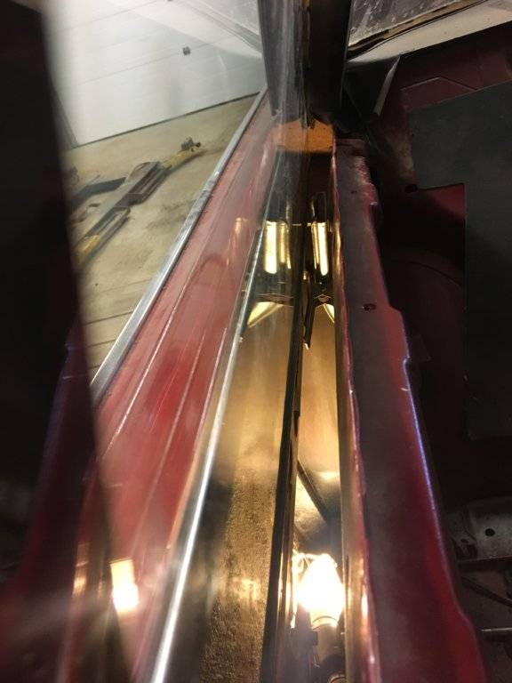

I took some pictures as I assembled the rear quarter window after I replaced the whiskers, and rebuilt the rollers. I'll let the pictures do the talking.
Install those two guide channels first.
Then slide the on rollers except that top front one by your thumb.
That is easier to bolt to window bracket out of the car.

Once the window is in place with both front guide rollers on the track channel, clamp the window to hold it maybe halfway up.
Then you have to crank the regulator up or down to line up the rear slider/rollers with their ound “entry holes” at end of slots in glass bracket.
