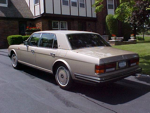

    I've always used whitewall cleaner and a stiff brush. I keep the car body very wet while doing it, the whitewall cleaner should not run off on dry paint. I do a quarter section at a time, rinsing it well. After it dries, I may do it again if needed. If not, I apply two (2) coats of Mop & Glo vinyl; floor wax. I pot it on with a sponge, let it dry, next day apply one more. I've used this product for 40+ years on all the Everflex vinyl; roofs on every Rolls-Royce or Bentley I've sold. It brings out the original sheen, and protects the vinyl top. Here's a photo of my 30 year old Silver Spur with the ORIGINAL VINYL TOP, only Mop & Glo was ever used as a protectant:
    Happy Motoring!

    Sorry, I couldnt resist :lol:
    Nice Rolls btw!!
