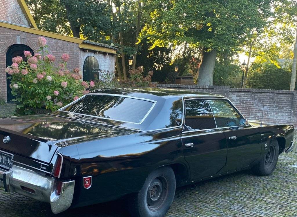

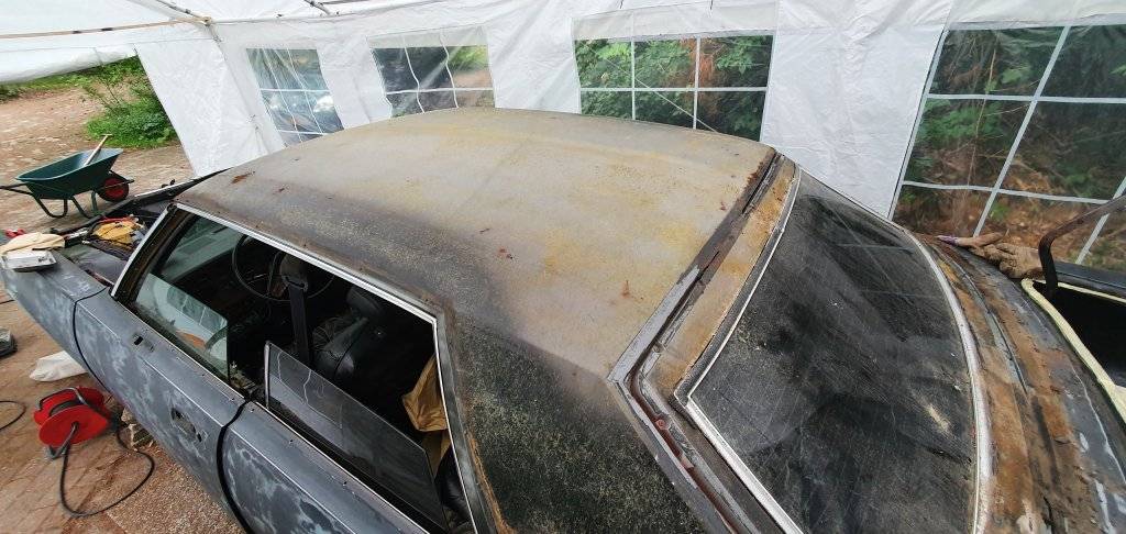

This is what it looked like after I pulled the vinyl top off of my 75 Imperial. There was body color on the c pillars and above side windows, the rest was just primer. Like others have mentioned getting all the glue off is a pain. I ended up using some heavy sticker remover.
Big issue is what you do with the rear window plug.
But I'm a sucker for painted roofs
That painted roof looks fantastic!
You answered my question exactly. Thank you for posting the pictures.
@thethee That looks amazing!
"Big issue is what you do with the rear window plug."
So, what did you do to achieve that good of a look?
I'm not a body man nor a painter, this was a first for me, but I'm pretty pleased with how it turned out. It's a decent 20 footer.
The rear window is bonded into a non metal frame and the gap between that and the roof is about 1" deep and 1/2" wide. Can't just slap some bondo on that, I knew that much going in. So I ended up using epoxy and fibreglass laminate to seal it and then several skim coats of filler. There was a  lot of sanding. The double curvature thats in that panel was really hard to get right since the plug and roof don't really line up from the start but that used to he hidden by the vinyl.
