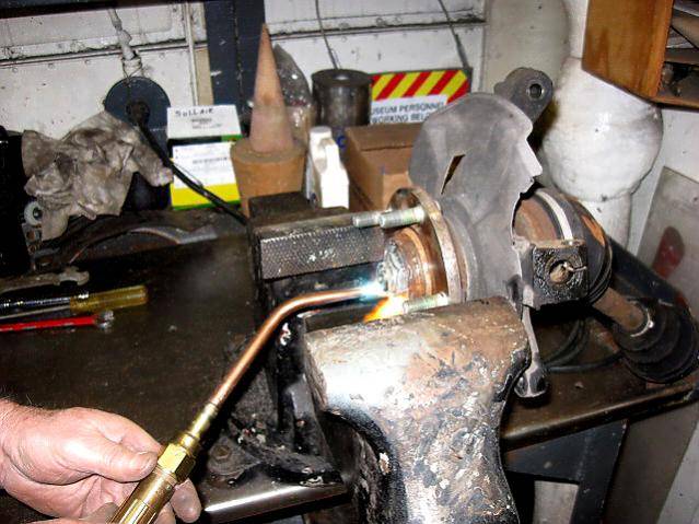

On a good note was down on the ship this morning. While Tom was welding up a new 7 ft. ladder I worked on the struts. Disassembled and transferred the springs over to the new ones and assembled. Then we put one hub in a big vise and hit it twice with an acetylene torch. Didn't get anywhere. Tom goes hmmm. That means he is getting a little irritated at the nut. Tom is very understated. Former Seabee and retired firefighter who does, fixes, and fabricates anything the ship may need. He gets his electric impact wrench and one nut takes 40 seconds before it starts to move. The other comes off in 10 seconds.

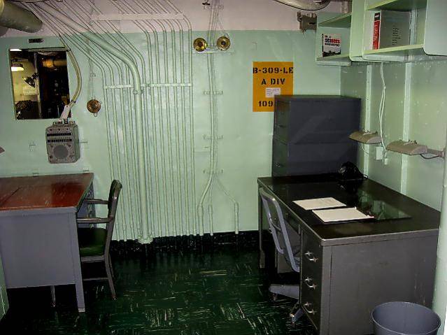

Cool stuff tbm .. I've had the opportunity to bash a shin and hit my head on a wall ornament a time or two and that second picture looks very familiar. Green tiles, steel desks, steel filing cabinets, steel chairs, even steel trash cans. That stuff was made to last. Surprised there's no 24 hour clock in that pic.
attachment.php
Clock is off to the left where it can't be seen. Oh, and what is an office without a typewriter. The desk to the left with the red top folds up in the middle to expose a typewriter that is fully functional. This compartment has been closed pretty much since 1970 and it was decided to open it up for Tom's use. Clean, paint, polish, and get new seat coverings for the swivel chair on the right. Ship's machine shop is through the opening on the left.
Stan was impressed that I restore a torpedo bomber. Well, actually this June 1st will be the start of my 16th year restoring the aircraft carrier USS HORNET at the former NAS Alameda. So far 15 years and over 9000 hours. Here's a pic below which most every one in the Navy should recognize provided they had one on their ship - Gedunk
