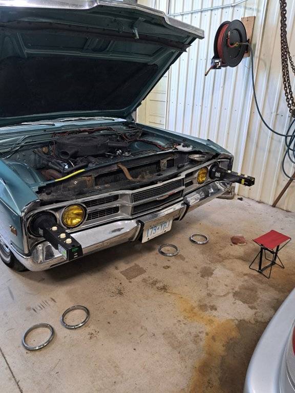

So Tracing wiring I learned my dad had rewired the headlights of the Polara. Not surprised, we're both electrical minded people.
What I thought curious is that the 2 relays and fuses (high&low) are both mounted right under the battery on the left front of the engine compartment.
The power wires both wrap 3/4 of the entire area and look to have been tied directly into the alternator post.
Why there? all that extra wire, isn't it about equivalent to tying it straight to the battery? or was he pulling off the alt directly to save current on the charging circuit as well?
I guess I don't see a problem, so unless someone here has an explanation, maybe I just tie them back in there and hit the road.

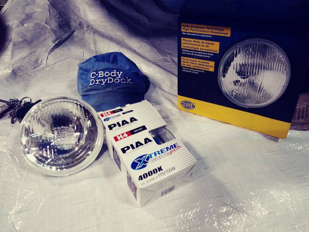

My experience LED headlamps is they have a shorter throw of light versus good quality halogens.
Also the older cars headlight buckets do not have the space and/ or room behind them as some LED headlamps have heat sinks or built on cooling fans.
Make sure you align the headlamps after installing your bulbs.
