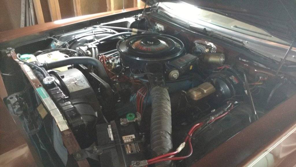

Previous owner had bypassed the heater, so now i'm trying to put it back. but i can't find a good diagram for the heater hoses. my service manual image is nearly illegible. does anyone have a diagram, or can take a picture of yours and share? thanks.

Is this for a '77 New Yorker as your username implies or another c-body? If it is, I can see if I can find a picture of the engine on my grandpa's all-original 12,8xx mile '77 New Yorker that he bought and ordered new. The heater hoses have never been touched. The only thing that might make it different is that it was ordered (by him) without A/C and that's going to make some things on it different than 99.9% of the other '77 New Yorkers out there. That might also include the heater hose routing and box.

Yep, for a 77....thanks

Sorry, these are the best I have. I really need to get some better pictures of this car...
This is a non-A/C car, but the hoses have never been touched on it.
