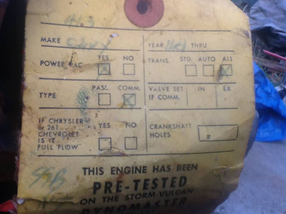

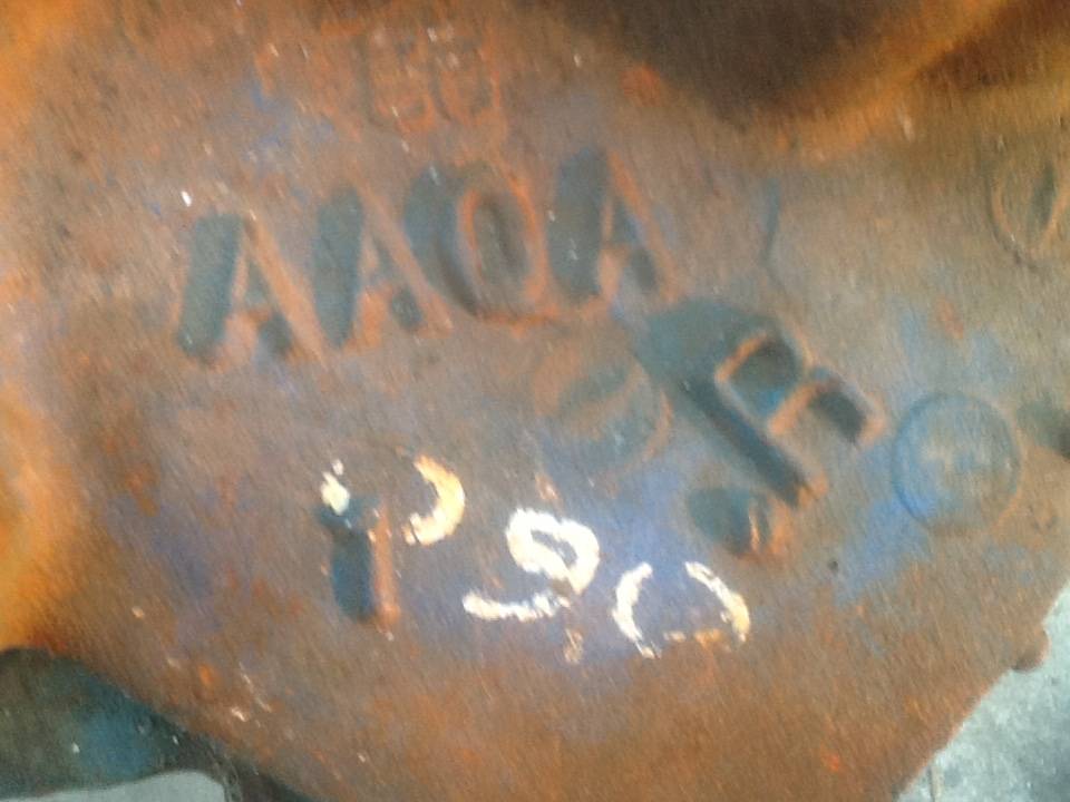

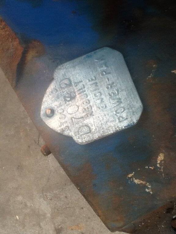

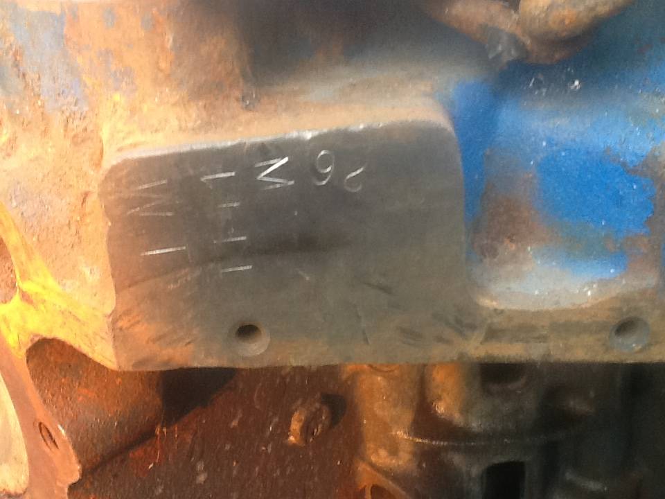

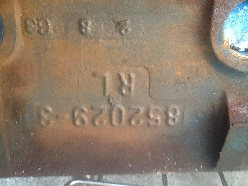

Picked this 63 413 engine today. Built 2/8/63 was in a old engine rebuilder shop. When business closed. Engine was stored outside under tarp so it is seized. Has rebuild tags.
Says its 60 over.

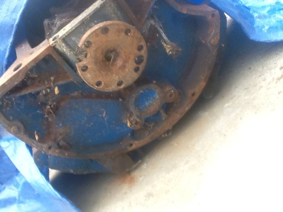

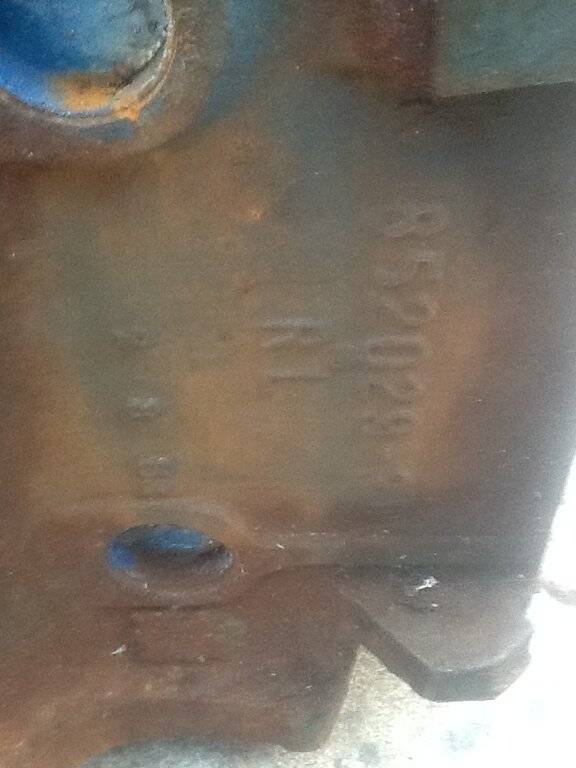

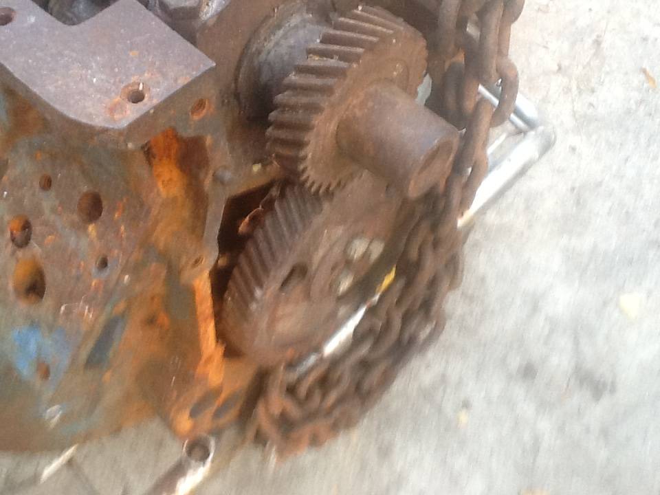

My questions for you guys are is this a industrial 413? It's has gear drive?
I didn't have to give much for it. I would like to use it in a 62 300.
I seem to remember hearing something about industrial motors turning backwards?
Another question is will 361 383 harmonic balancers work?

If this is a industrial 413, is it usable for a car? What are the differences from industrial motors?

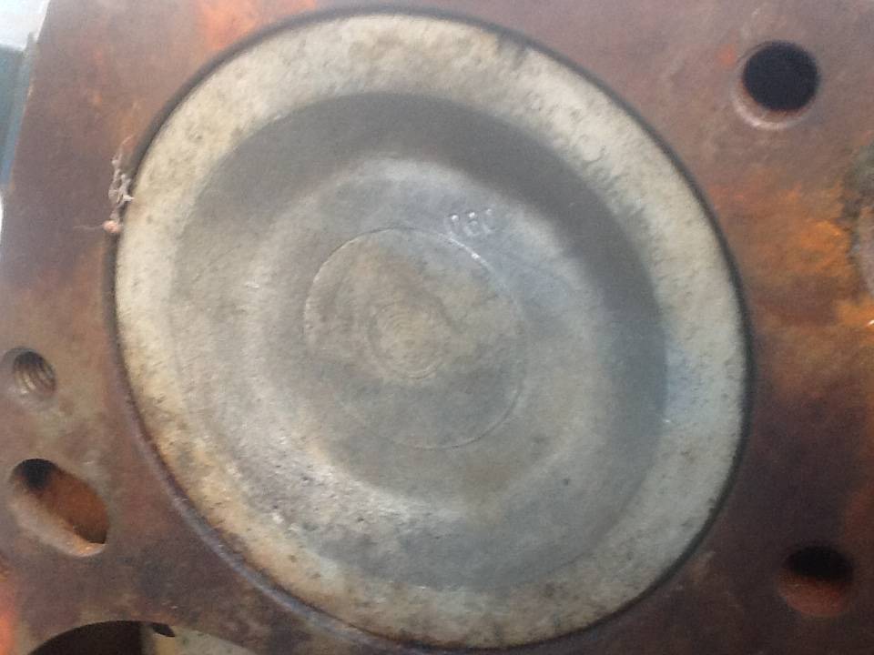

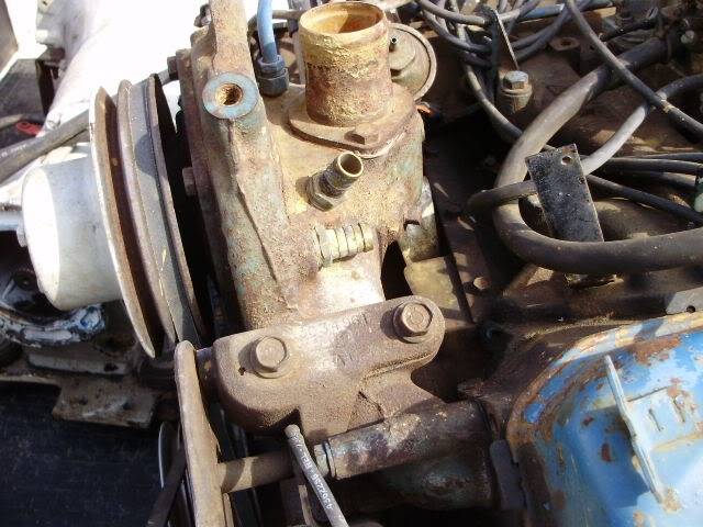

This engine has the industrial gear drive for the cam shaft. The truck-industrial engine had the high mount water pump with the discharge ports mounted to the "dash" heads. (photo below) It also has the low compression pistons typical of a truck/motor home/industrial engine. The industrial engine could be ordered either in a CW or a CCW rotation as noted above. My best guess is that this is either a passenger engine with an industrial gear set that was converted to low compression or a truck/industrial engine to start with. The casting numbers are usually the same for both.
The truck engine usually has a different crank shaft number so you might want to try and reference that number to see which crank the engine has. The truck crank usually had a larger rear flange.
