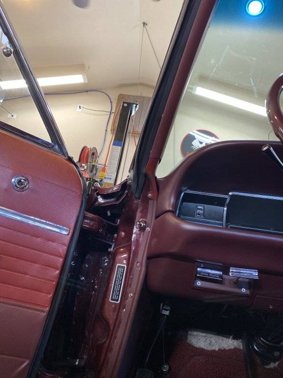

I have the 66 “metallic red” interior, but the cowl vent panels, window trim surround and lower dash panel are all different shades of red than the vinyl. How do I figure out the correct shades for those three items?
I would suspect that over the years and exposure to sun, the shades of the various parts have faded/changed but that the original interior was usually pretty uniform. I am mostly familiar with the fuselage vehicles and those generally were uniform in color so you might want to give them (Mike) a call to inquire about this is about all I can suggest.

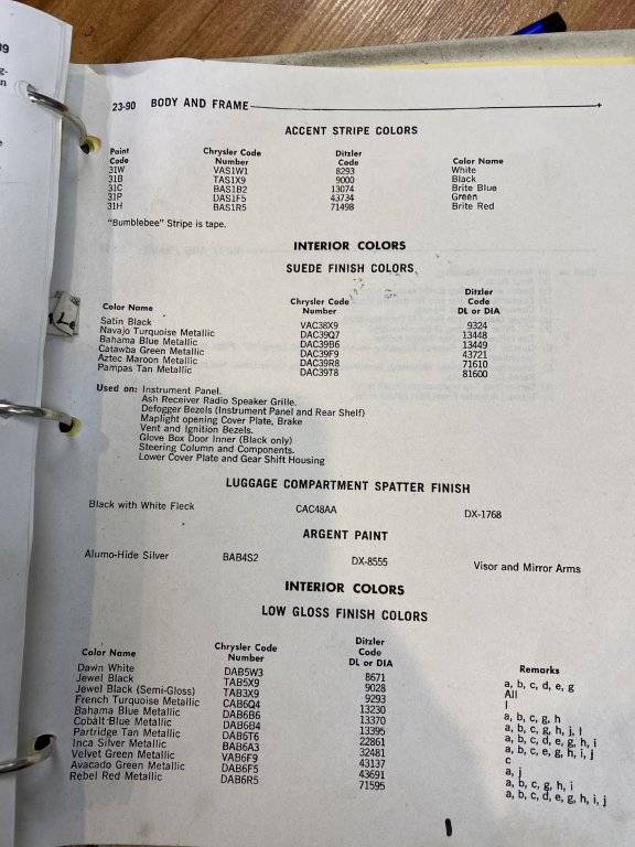

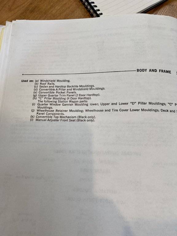

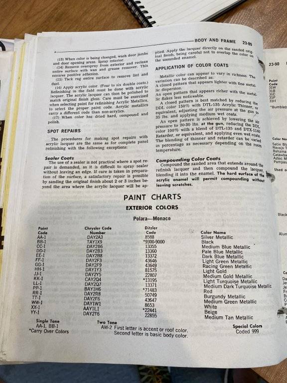

The Slabs had about 3 different shades of colors for the interior. In 68 they are listed in the back of the service manual. For my car (red interior). I have Aztec Maroon metallic suede, rebel red metallic and then a couple different vinyl colors that complement the paint.
