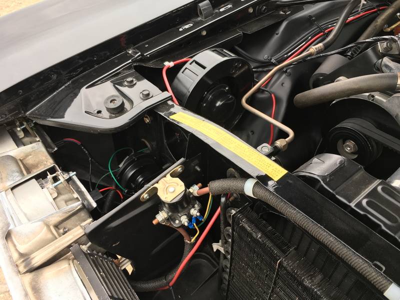

Any members that own a Mopar Police car know how they ran the siren through the horn switch?
CHP cut the wire at the base of the column. (CHP not Dodge/Mopar)
Ran the column side to the common on the dash toggle.
Ran the siren solenoid (Starter relay) to on side the switch and an extension to the original (cut) horn wire.
Alan
Alan
Thanks Alan, I heard some agencies used Ford style starter relays.
Here it is with the siren
