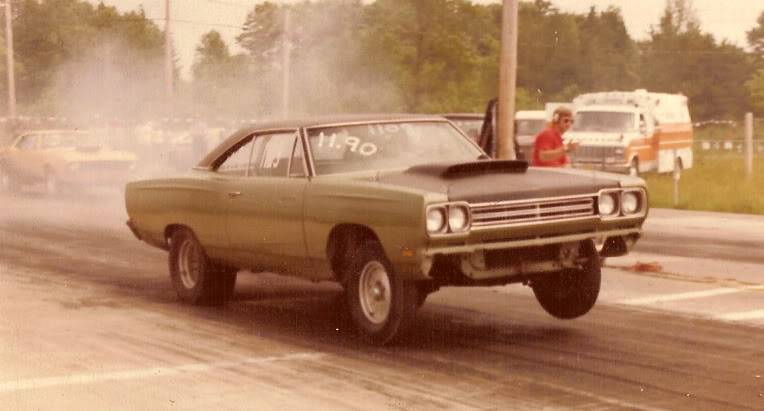

IMHO, no traction bars needed (they were meant for teh GM cars) and don't bother with the pinion snubber. If you really need to get serious, clamp the front half of the spring in a couple spots and call it a day.
Here's a pic from way back in the early seventies. Stock rear springs with the front clamped, 9" tires and am 8 3/4 rear. No pinion snubber (not even the stock one).

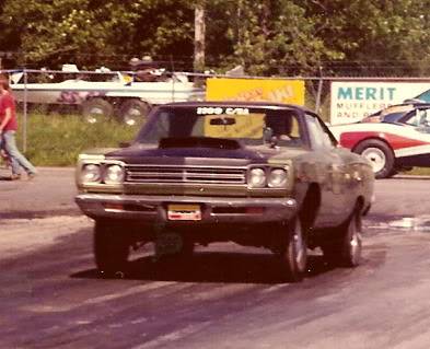

Same car in bracket race trim with 10 1/2 tires and same setup. I musta been playing games with the times that day because the car ran a lot faster.
