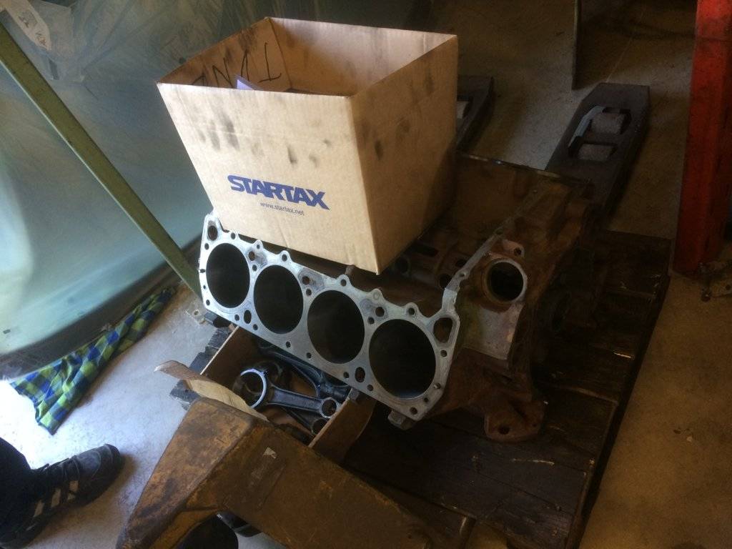

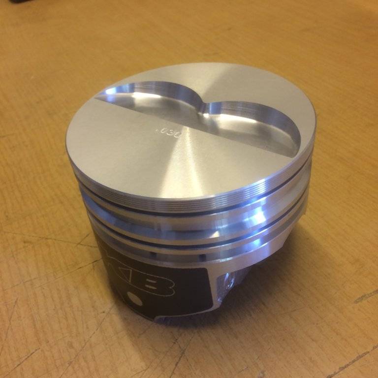

    7FD18ED1-A038-4FC9-B7E9-A84C7BF5BBF9.jpeg 5AB4719A-CEF6-4796-B1F3-90A3CF8B7104.jpeg My ’69 440 is being rebuilt. Due to slight corrosion on top of the cylinders it was deemed necessary to bore it over. We ended up to 0.03”, and a set of KB Hypereutic flat top pistons, some decking, etc, basic rebuild stuff. - Now, as I’m extremely uncomfortable with those dimensions, I find it impossible to calculate the resulting volume. Can you help me: how much volume the 440 will have as a result? Closer to 450 or so?

    it's 446 cid now. No need to worry about that. It's a normal service to refinish to that size.
    PS - are you sure those are hyper pistons? They don't look like what I remember. The top ring gap will be important to "get right" for the piston used.

    Your welcome, now we can move onto a Hypereutectic -vs- Cast -vs- Forged Pistons thread!

    Thanks, but no thanks, I'd rather not get into that discussion. Hypereutectic will suffice for my purposes. I'm not looking for a street&strip wonder. Instead, I'll be perfectly happy if my engine builder manages to find even close to all of the quoted 350 ponies... many of which were missing in the first place... LOL.

    The machinist who rebuilt my 440 also used hypereutectic pistons. They are a more than adequate replacement for stock cast pistons.
