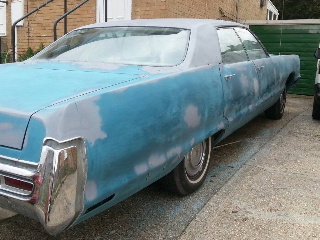

hi looking to paint my new yorker in metallic red white roof ,how much paint do yo
u think i will need

I can't quote your quantity however looking at that one pic, I am wondering if you're going to remove the handles and bumpers? Well worth it at this point, and No! Not Red! The Blue is nice. Looks solid.
