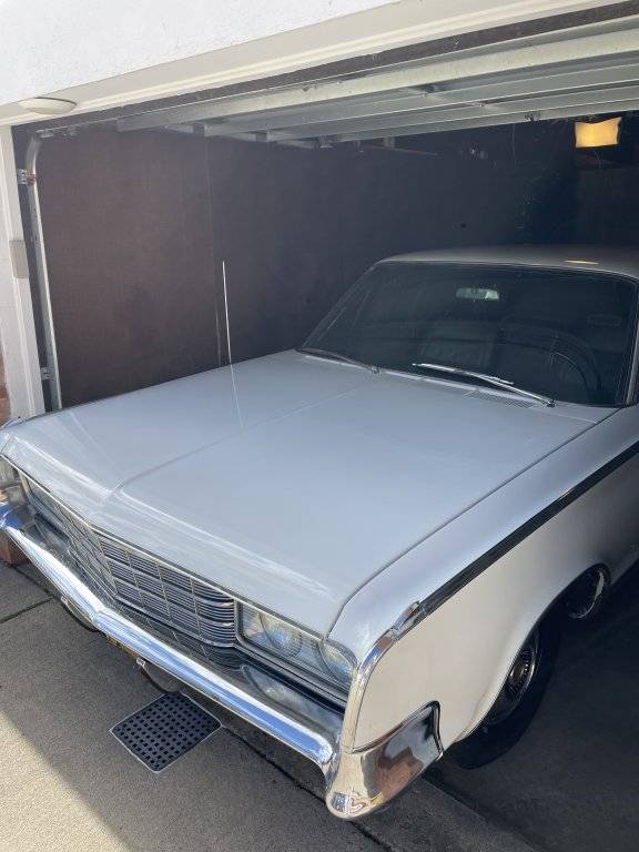

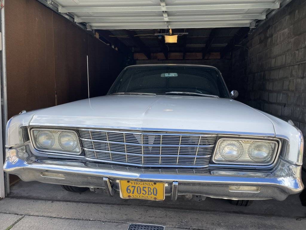

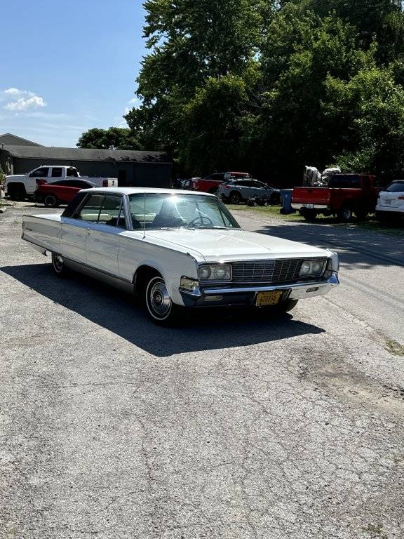

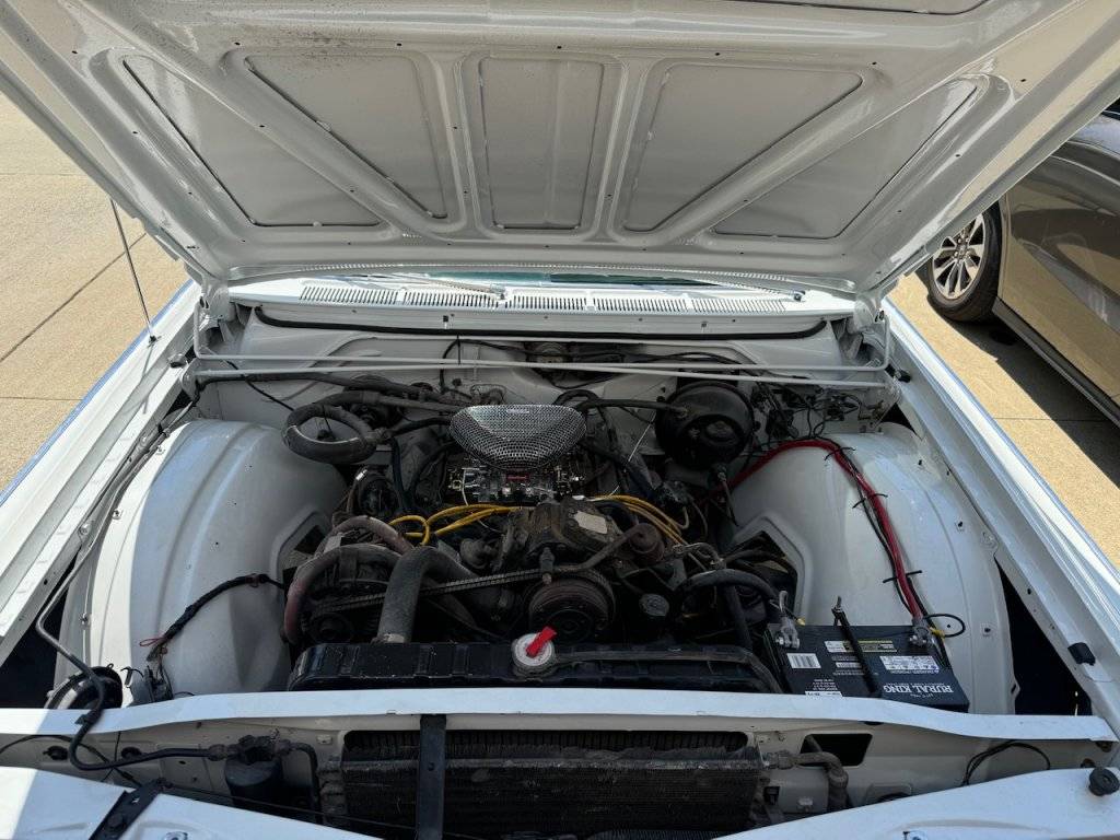

Here are some recent photos.
Don’t have hands to help get it back in the garage so side view is tough.
Oooh, the rare "white" taillights! It looks like a really nice car. 4-door hardtop flavor!
Nice!! Looks like an easy project car. I hate rust....this car looks like it has none.
drtrubs
Great looking NYer. If the underside is as clean as the rest, what a find.
Only item I see missing is the upper 'A' arm splash shields. Those are available in the after-market.
Would great to see it a Carlisle this summer.
