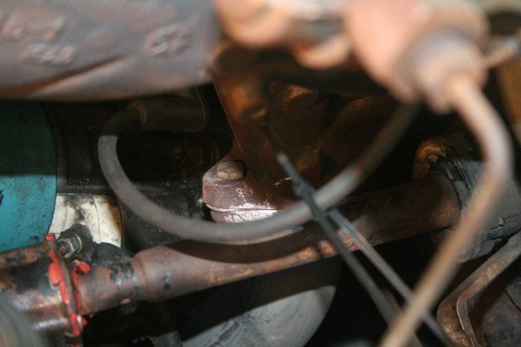

1) I didn't change anything, as in altering the car from stock. My car needed exhaust so I drop it to the shop with the original logs on. They swapped the manifolds out and installed new duals; 2-1/2" to the muffler with 2-14" tail pipes.
2) There are no issues with the passenger side manifold. You can drop the exhaust off of it and remove the manifold with ease. Everything can be done from leaning over the fender.
The driver side is another story. The manifold I used the flange does not run parallel with the side of the car. If you ever have to drop the exhaust it is a real chore to get the exhaust bolted back up to the flange on the manifold. The easiest way that I've found to do it is to remove the manifold from the head. Put tape around the head of the bolt, insert the bolt in the manifold, then place a long extension with a universal and the socket on the bolt head. Now you can install the manifold and hope the socket doesn't fall off. I don't think you're going to notice any performance increase in a 4000# car.
You can see in the attached picture that seeing the front flange bowl on the driver side is easy enough the only way to see the back is from underneath. Then you can get one hand up there at best.
