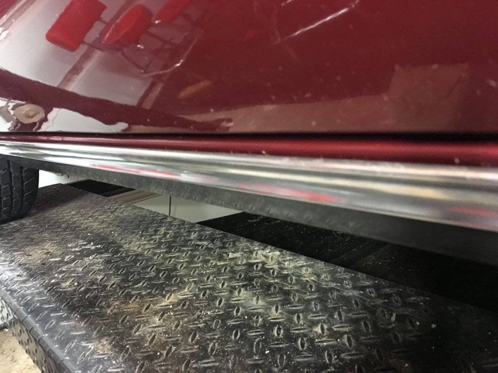

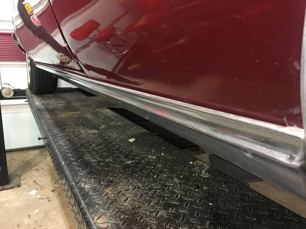

I finally got to restoring the kick plate trim on my 69 sport fury
A tip for install/removal is to "tap" them in/out of position by using a wooden paint stick (and a hammer).

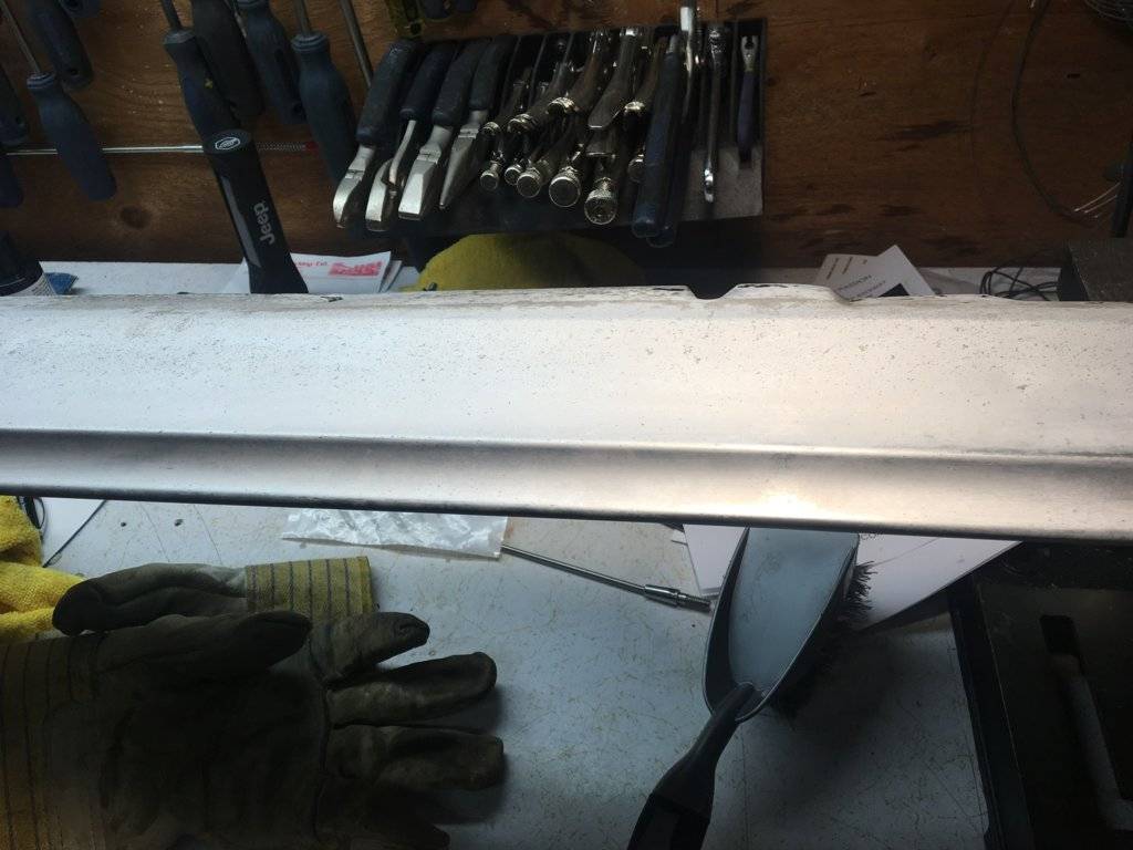

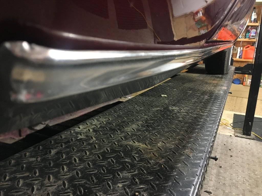

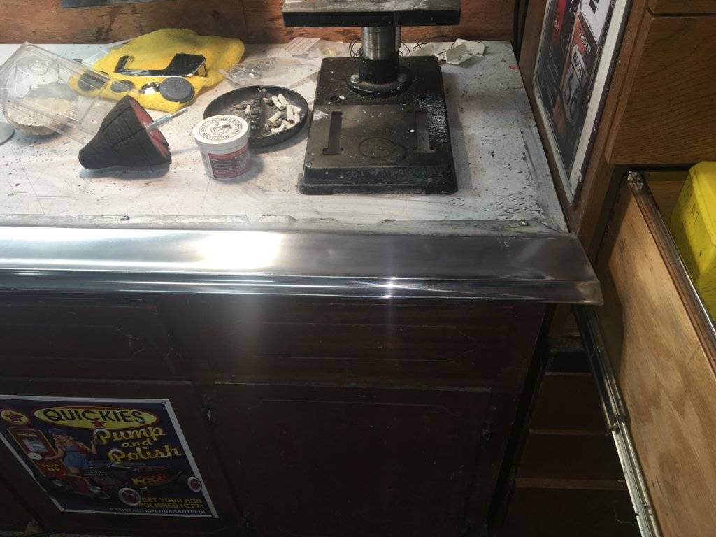

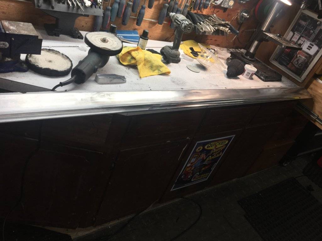

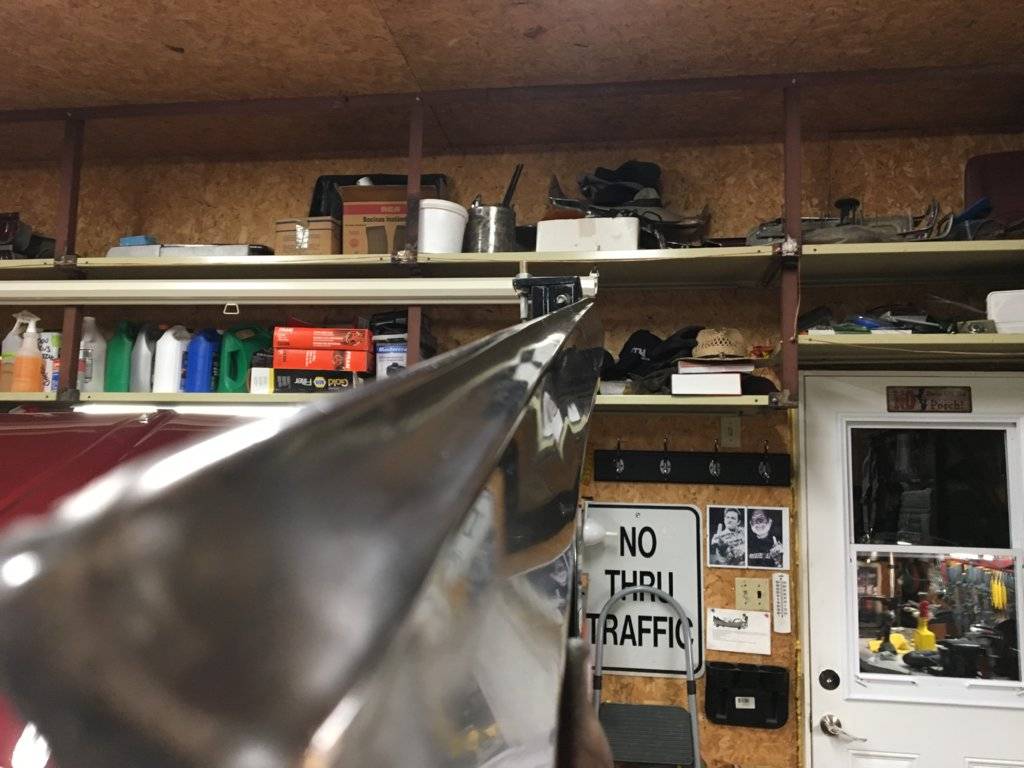

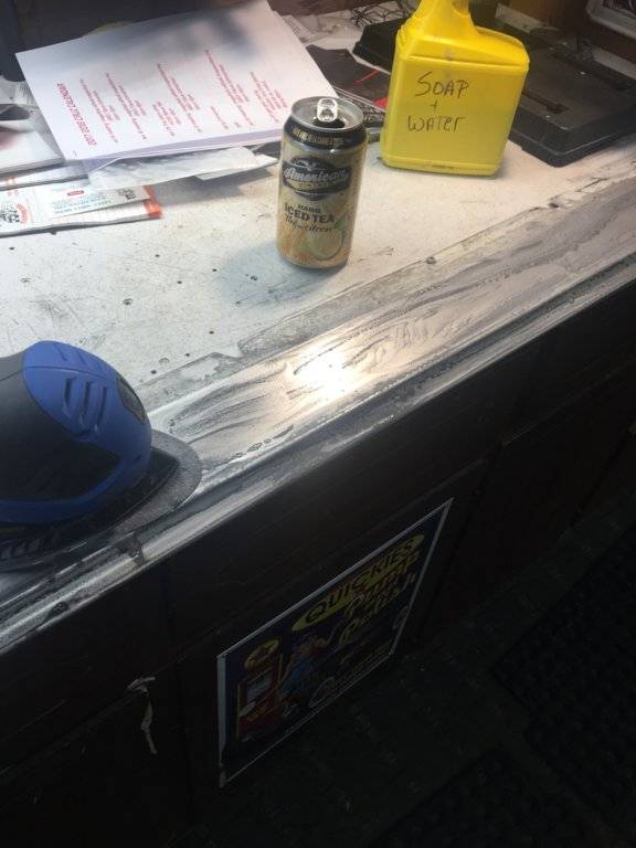

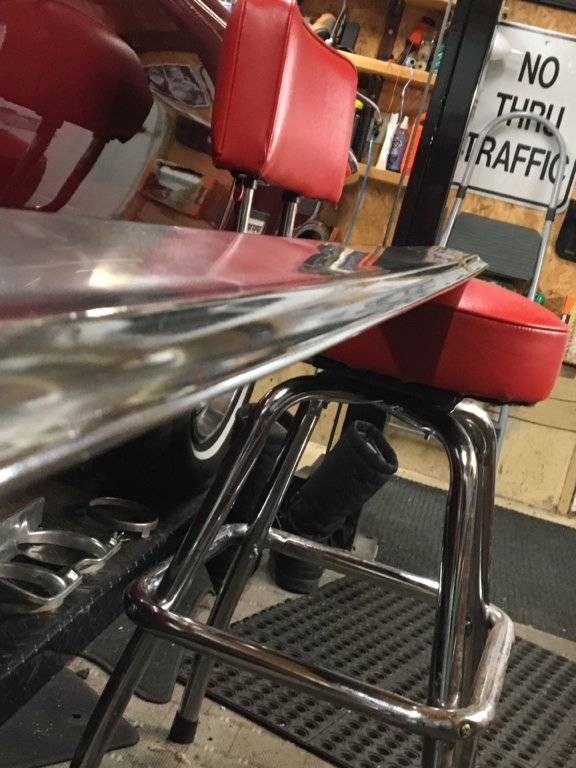

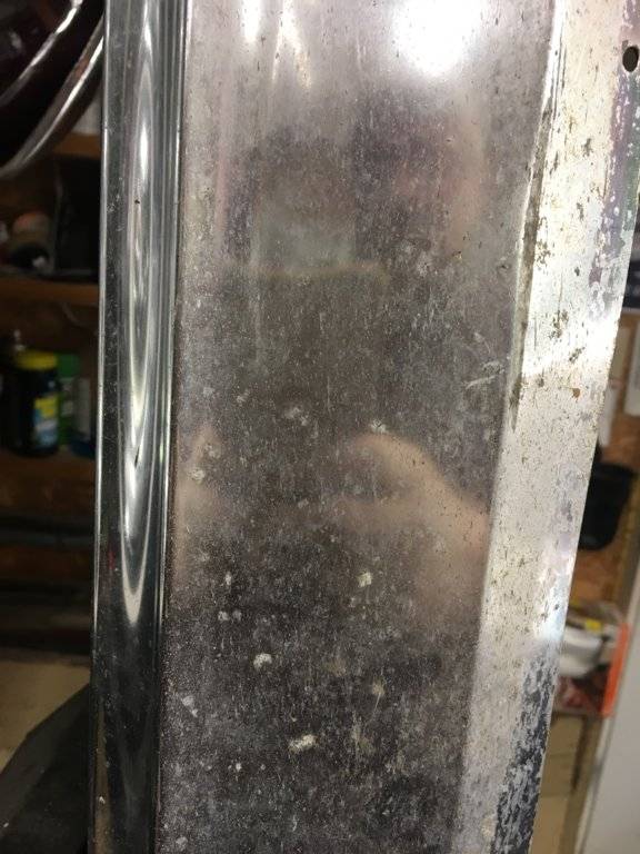

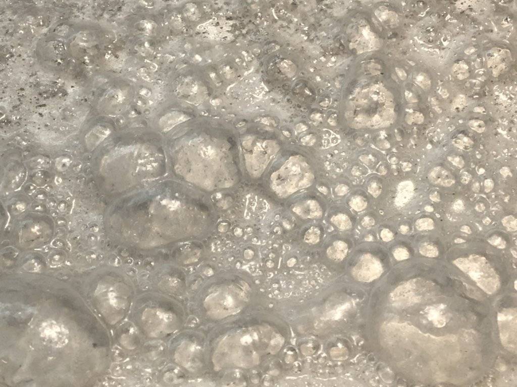

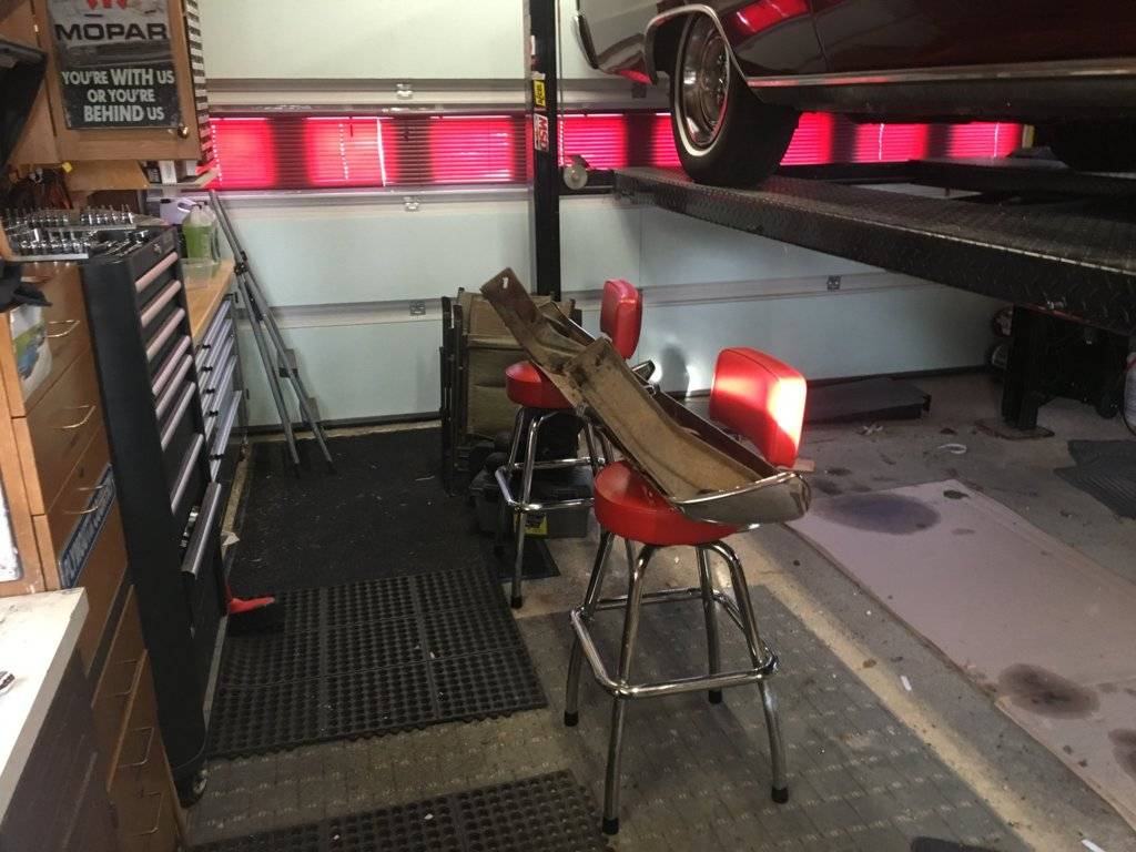

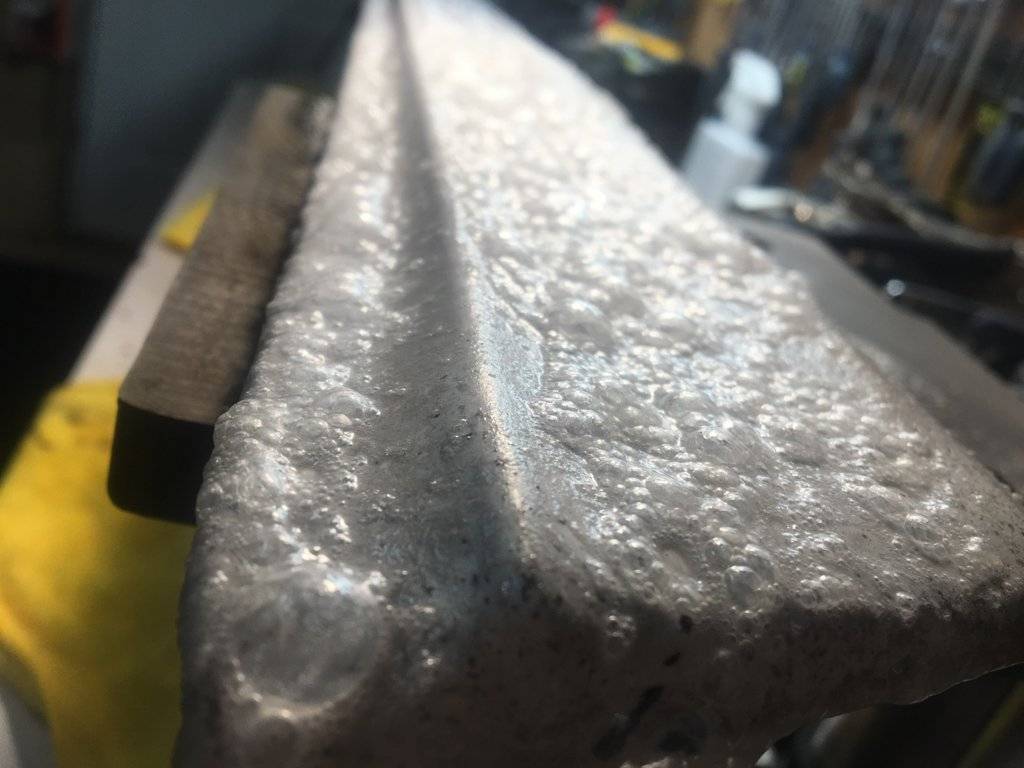

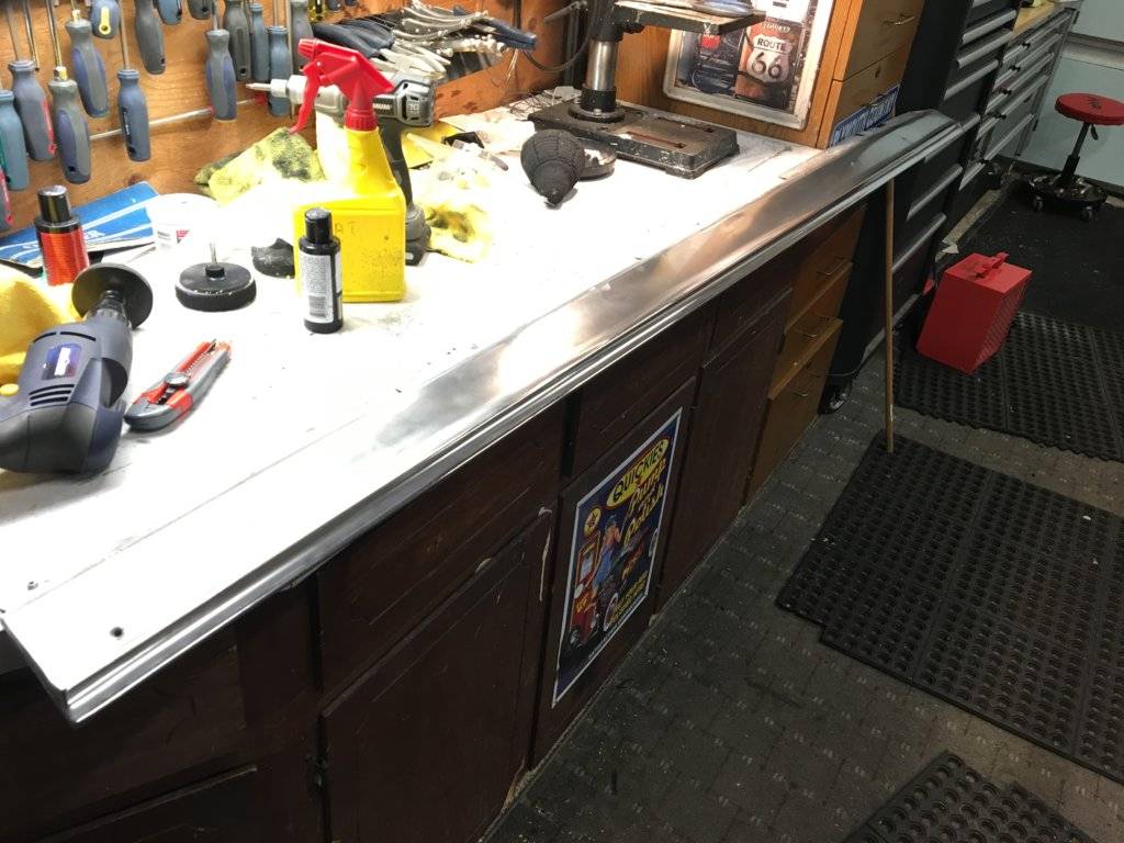

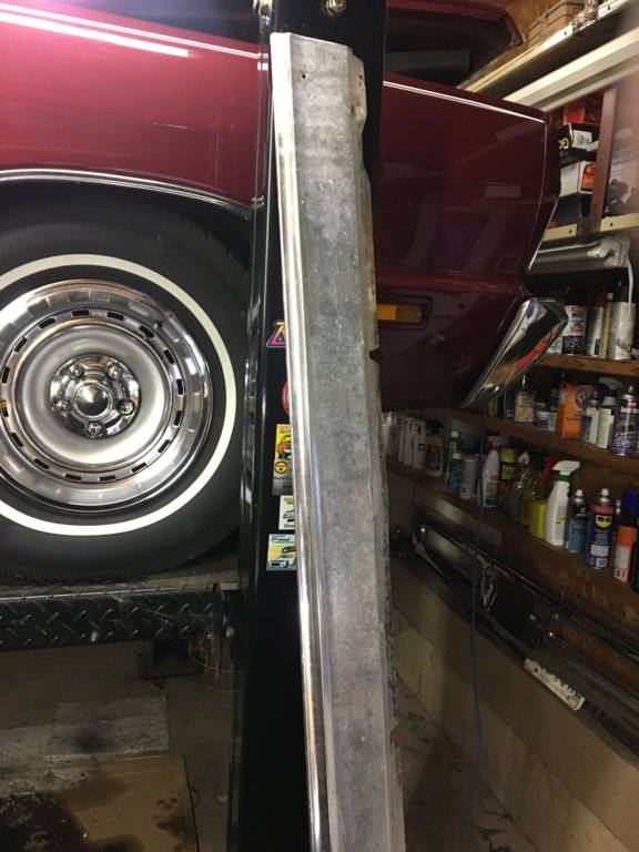

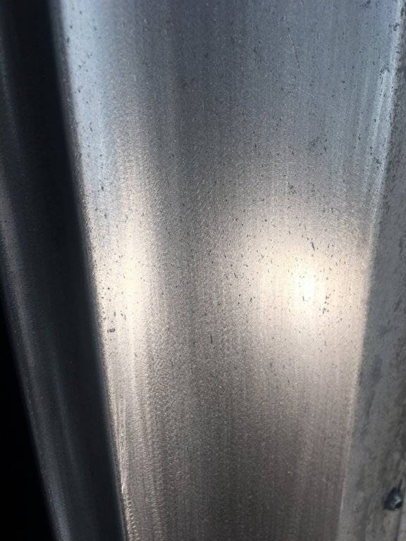

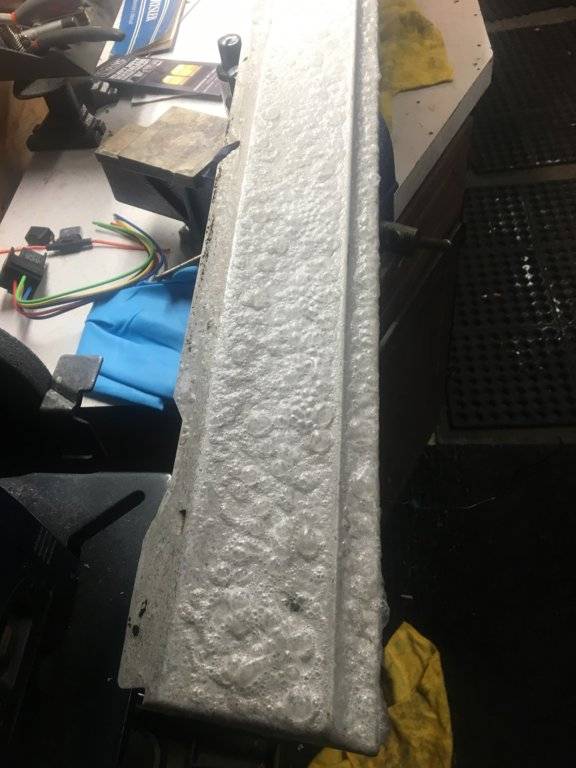

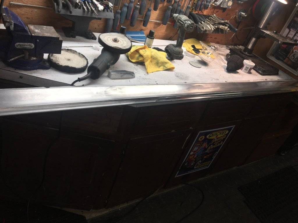

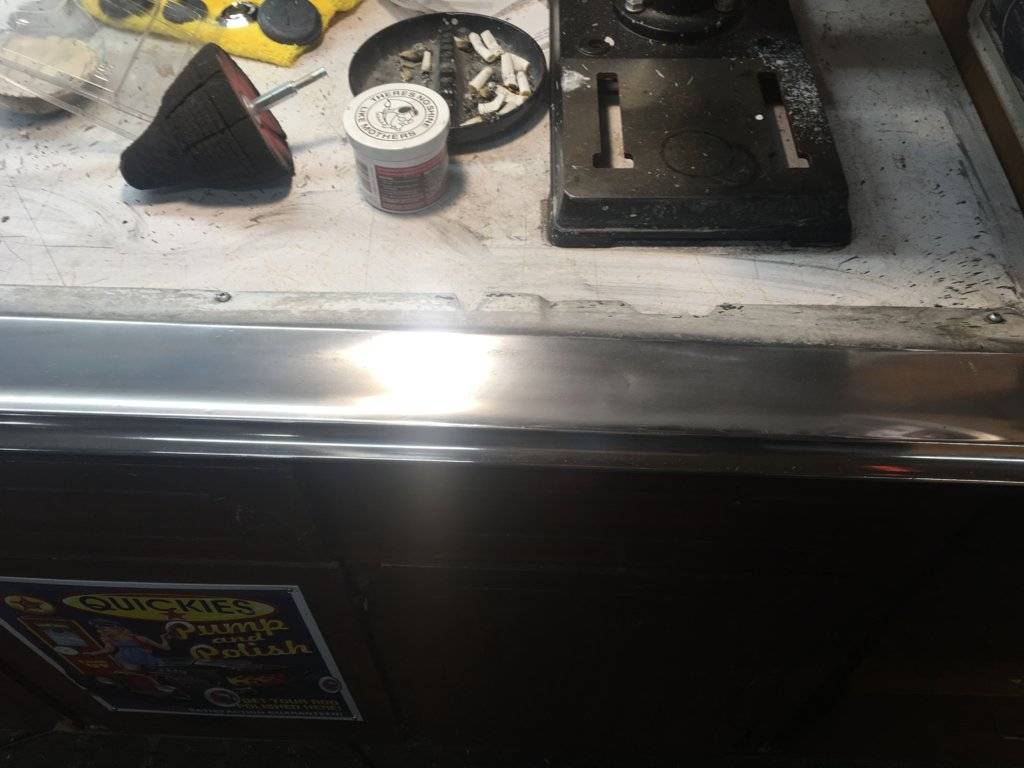

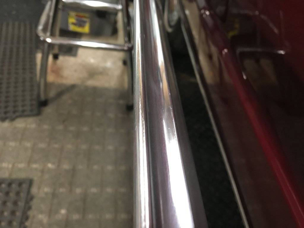

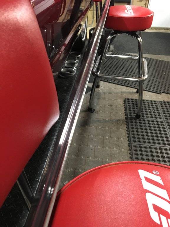

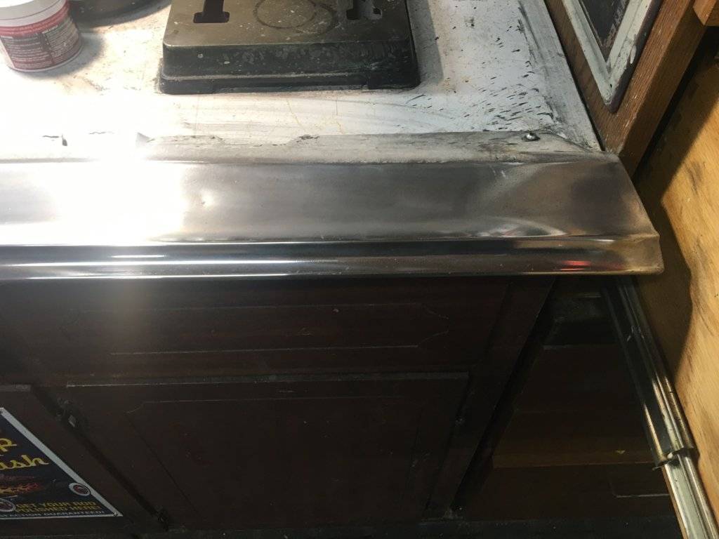

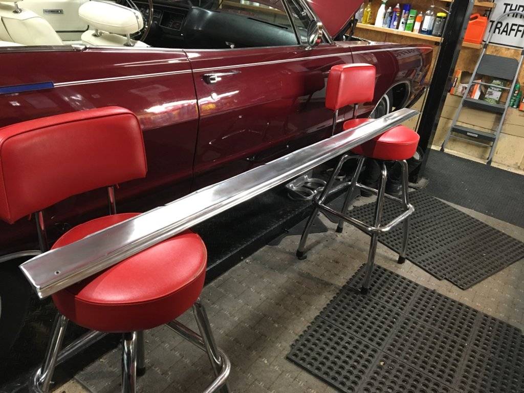

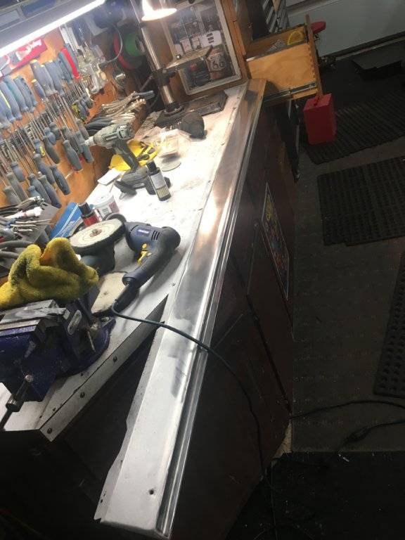

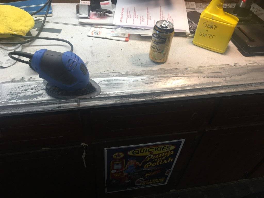

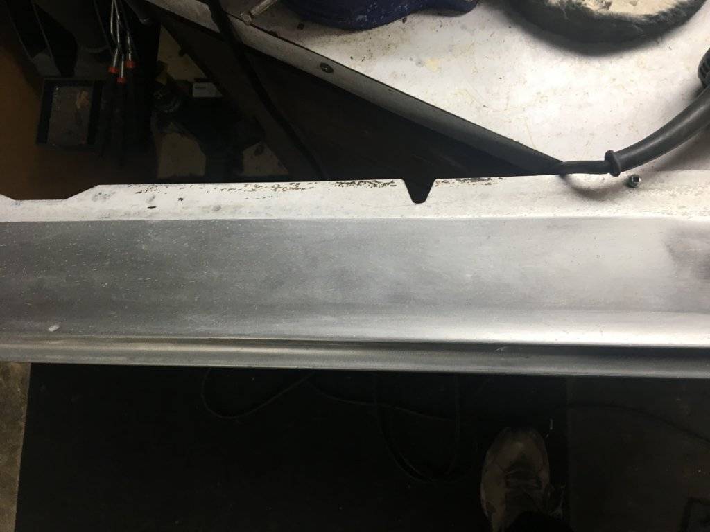

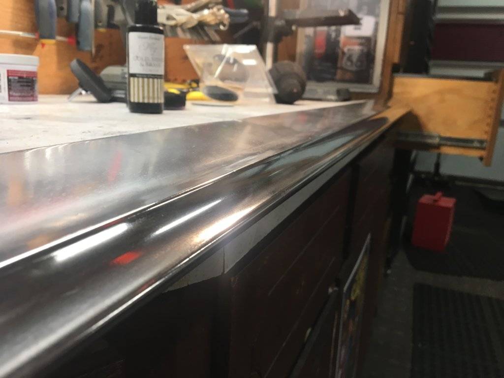

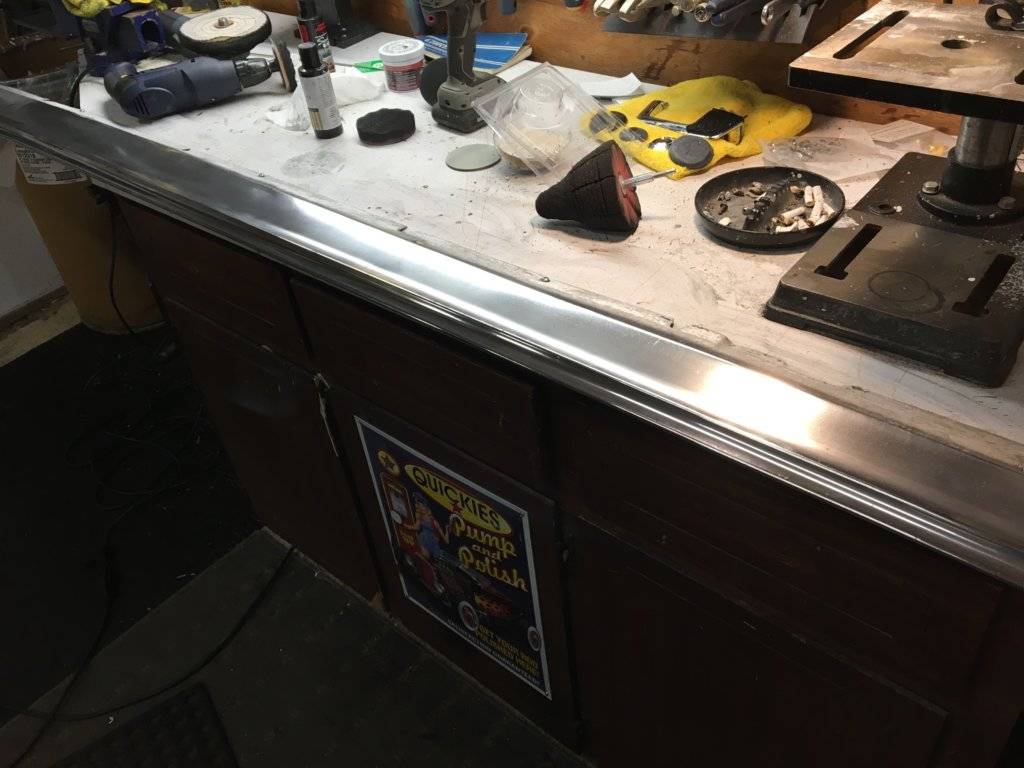

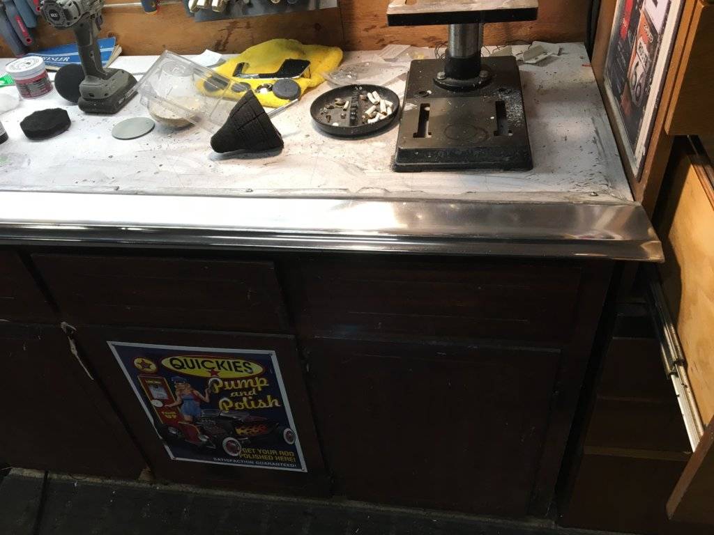

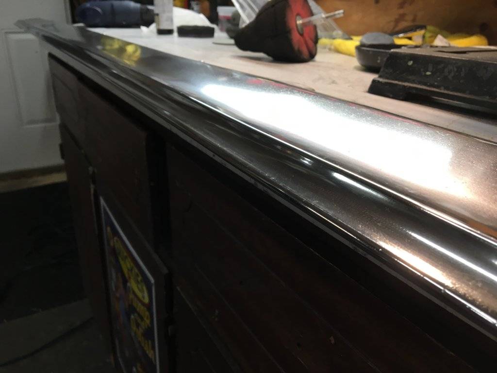

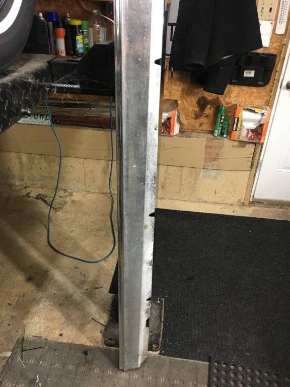

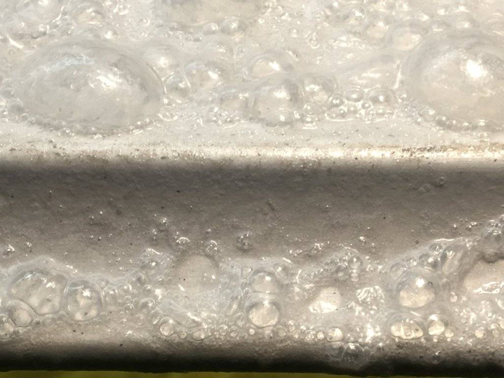

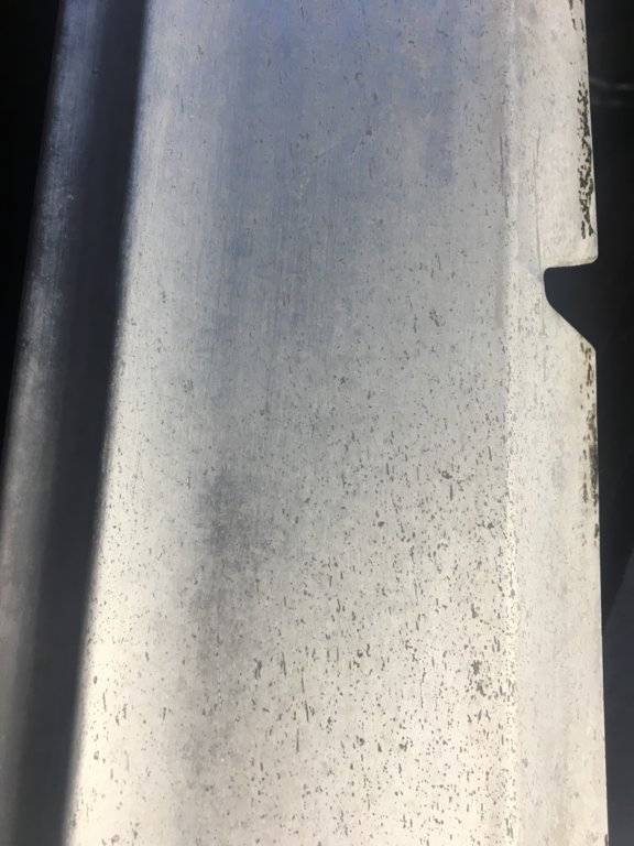

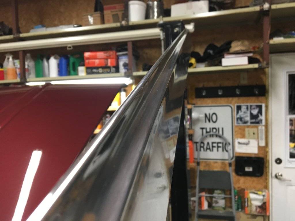

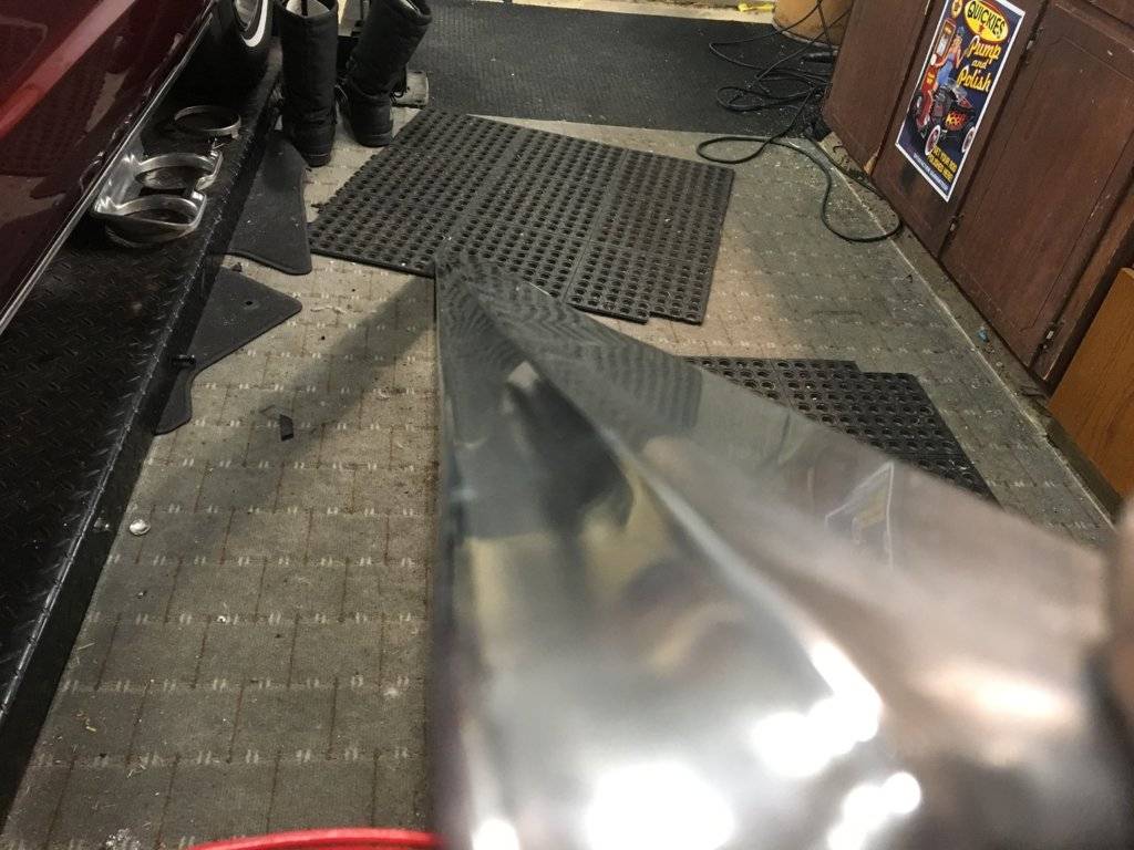

I finally got back to restoring the trim for the drivers side kick plate. I did things a bit different on this side that saved me about 30 hours of elbow grease sanding off the anodized Coating. I used easy off oven cleaner, it worked extremely well !!! Then I did a wet sand then used a sizzle wheel on a 5” angle grinder then used a brass and silver polish for the last step. It took about 20 hours to bring it to a nice shine. I’m not including the 4 hrs of tapping out the small dints in the trim that time can vary depending on how many dints you have. I’m going to post a few pictures of the process in my next post

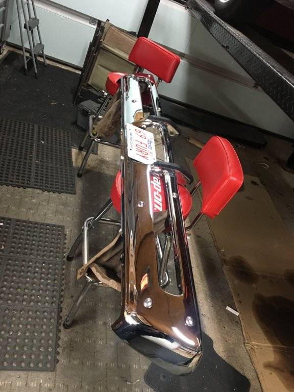

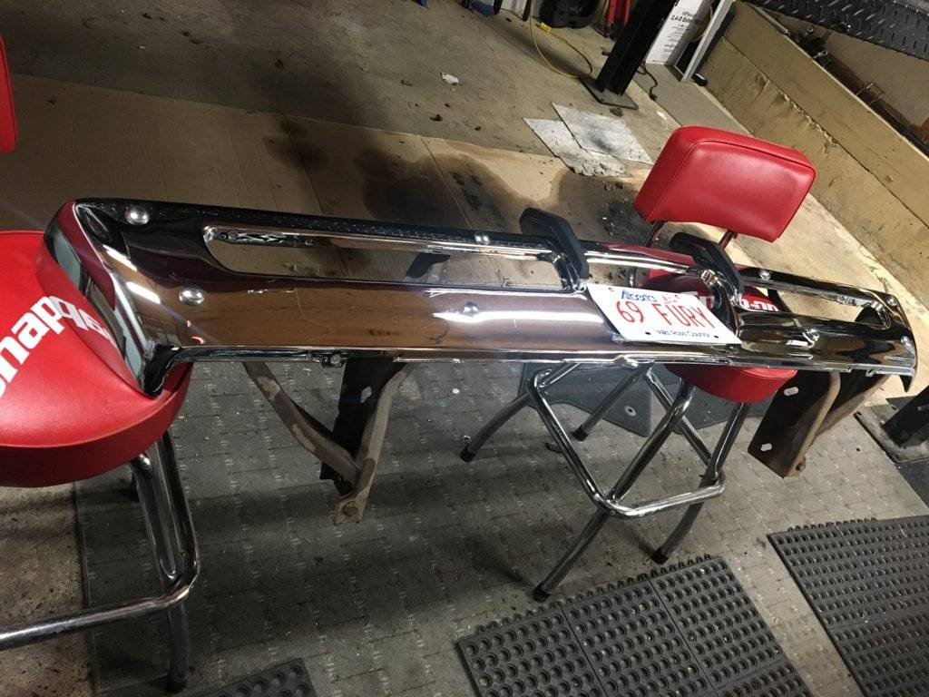

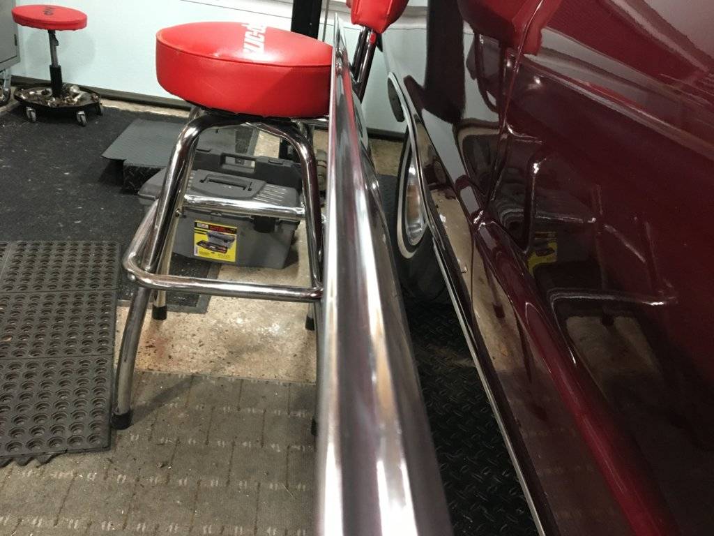

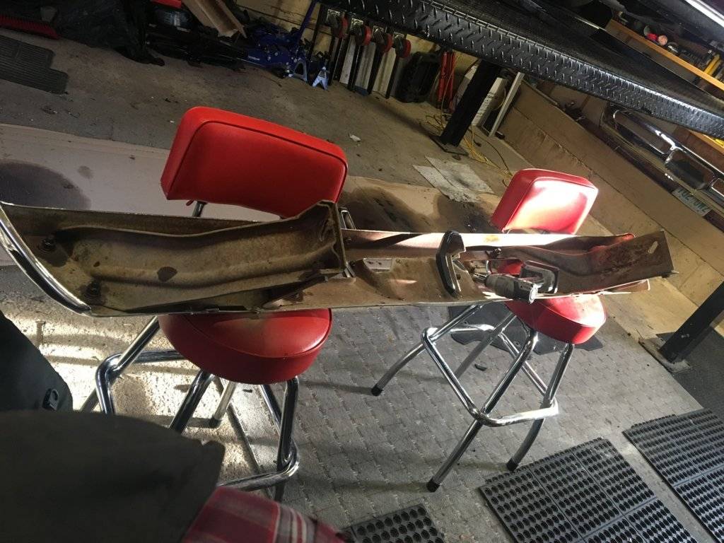

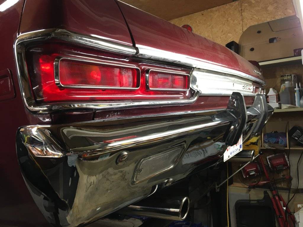

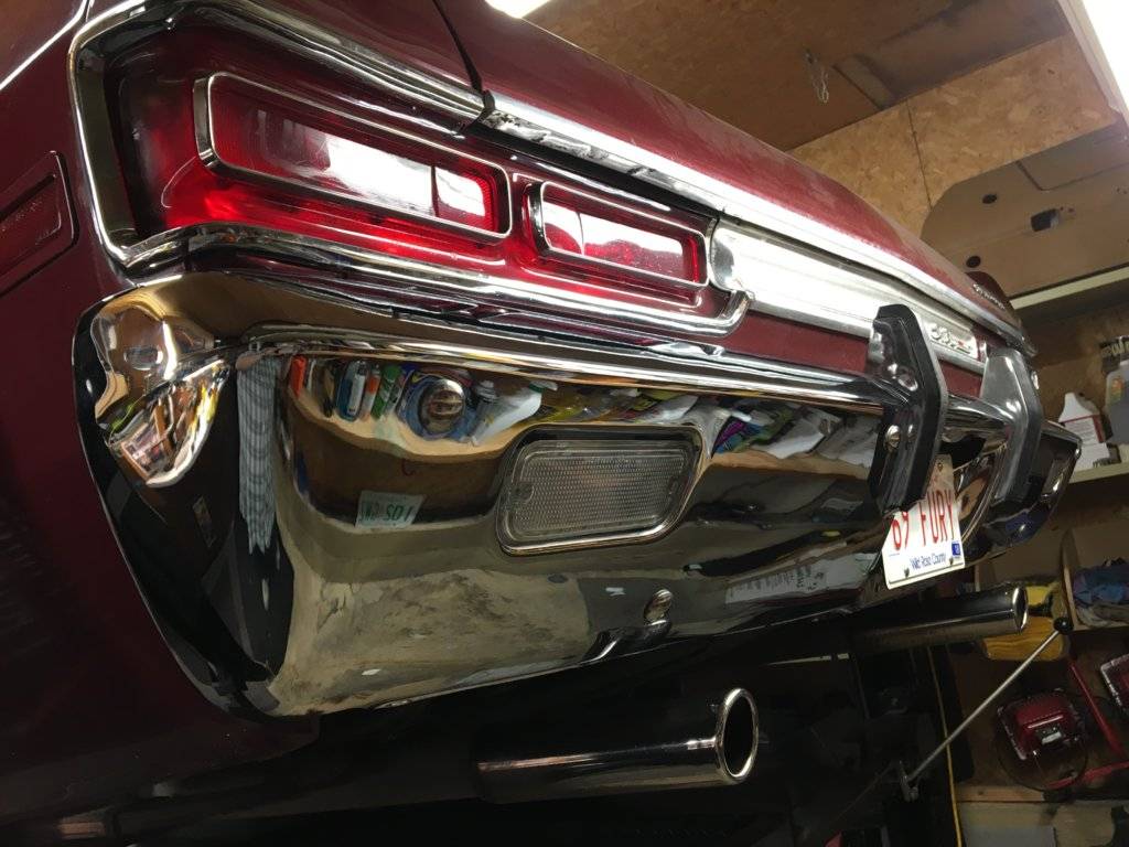

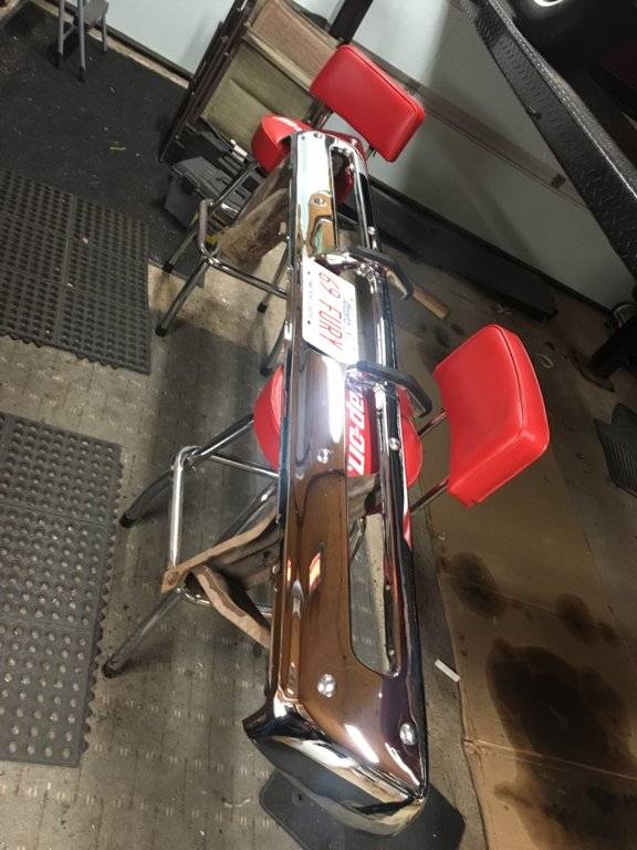

I started installing the freshly rechromed bummpers. I will have some more pictures later of them installed. Beware if you start this process buy new bumper bolts , I had to cut at least half off them off !
Bumpers installed next is the paint clean up. March 2nd -4 th world of wheels / Autorama Edmonton Alberta. They asked me to enter my car. it is about time the C body’s got a little bit of appreciation up North!

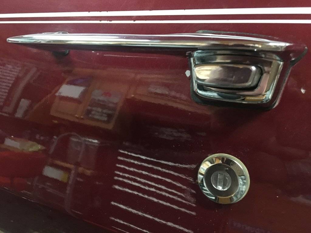

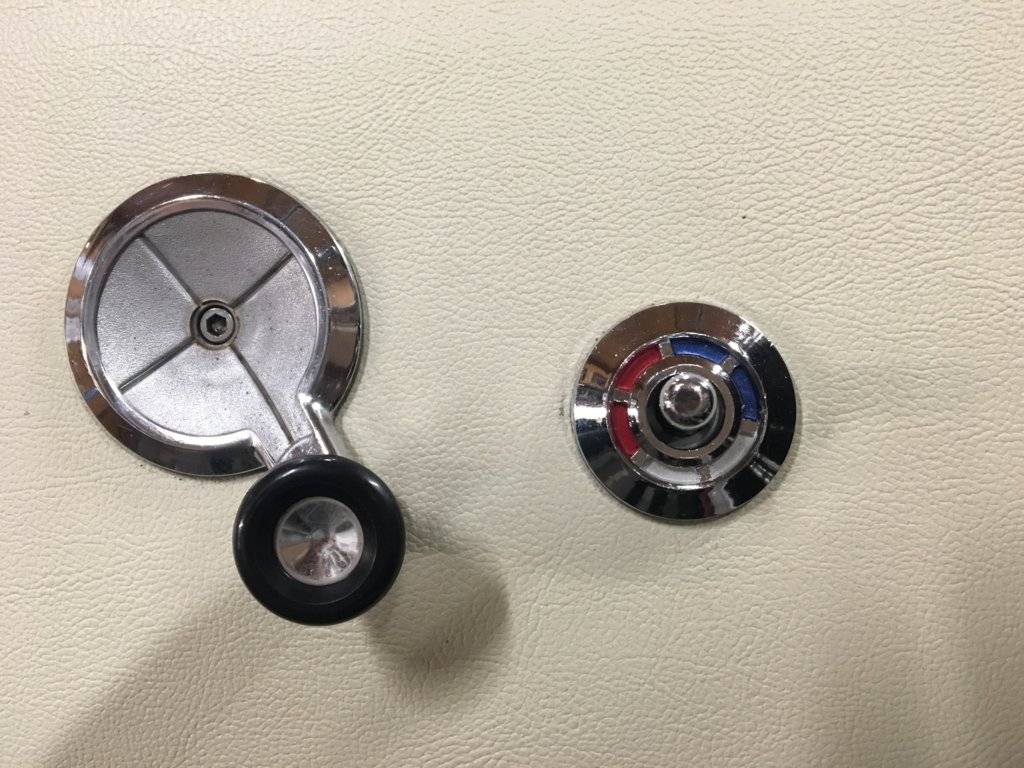

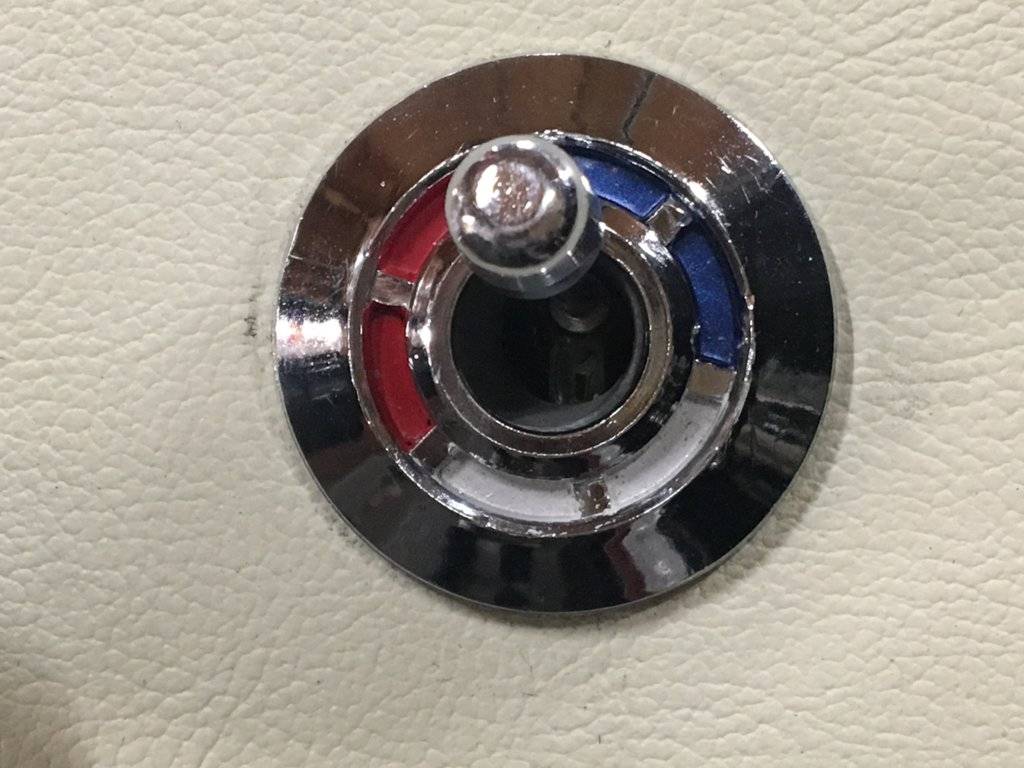

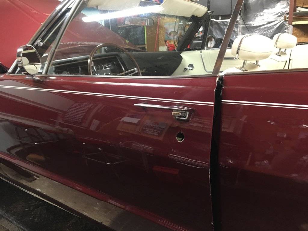

Time for the new locks for glove box console doors and trunk. , handles and ignition. I went to a locksmith and had everything made for 2 keys !! Finally for the first time since I have owned a Mopar only have to deal with two keys !!
