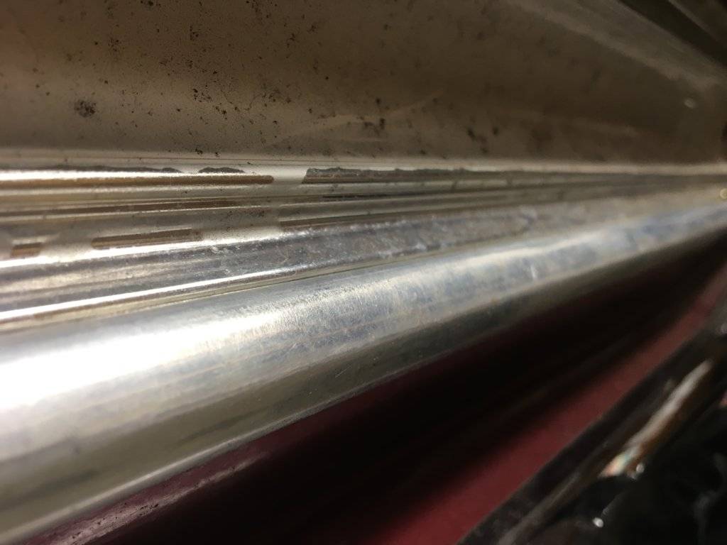

I finally got to restoring the kick plate trim on my 69 sport fury

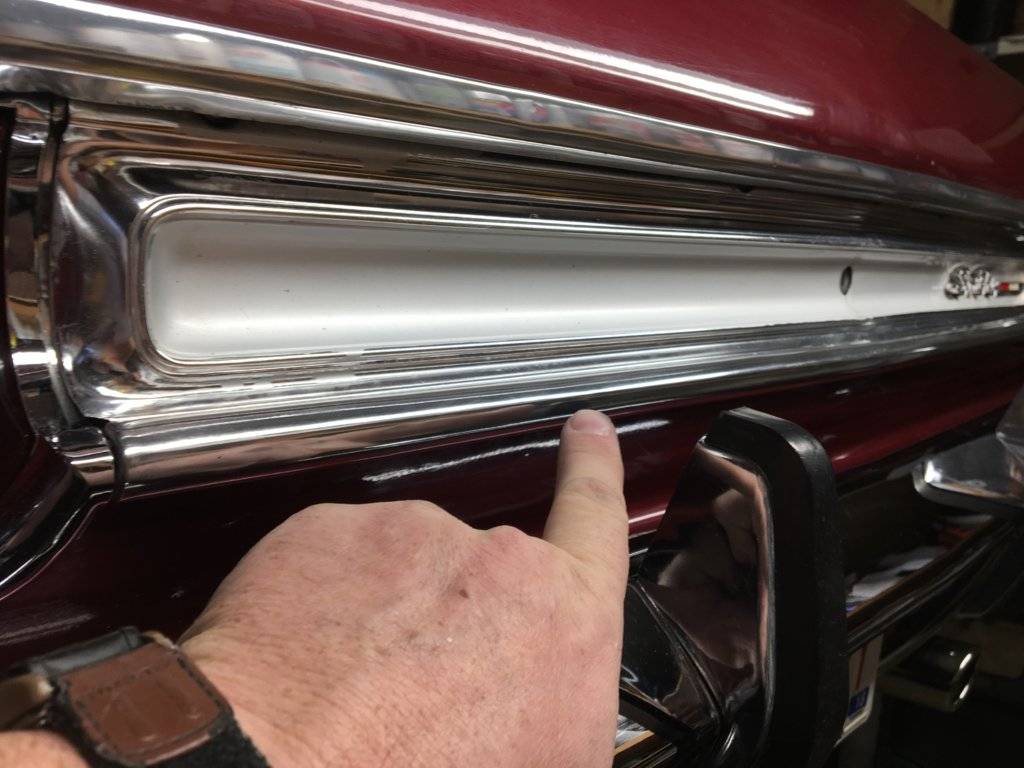

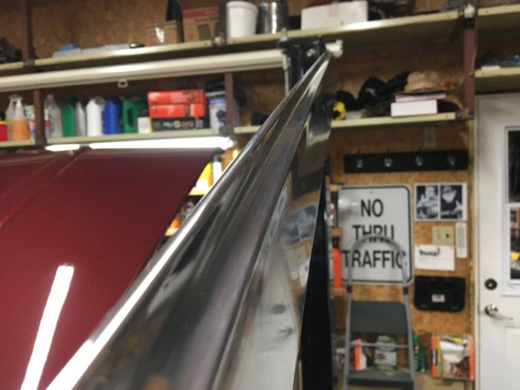

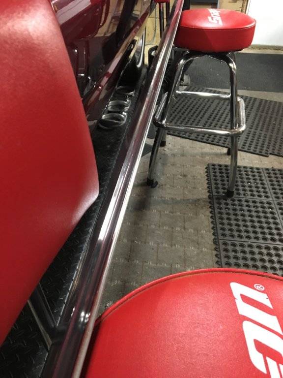

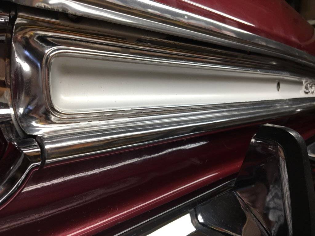

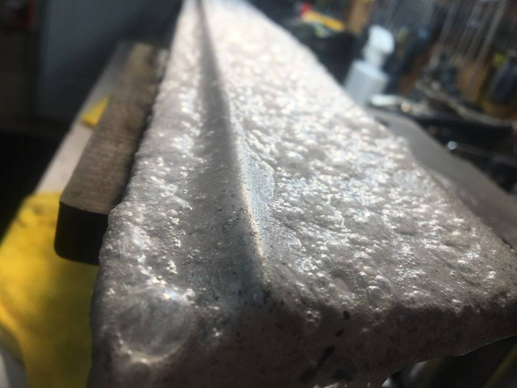

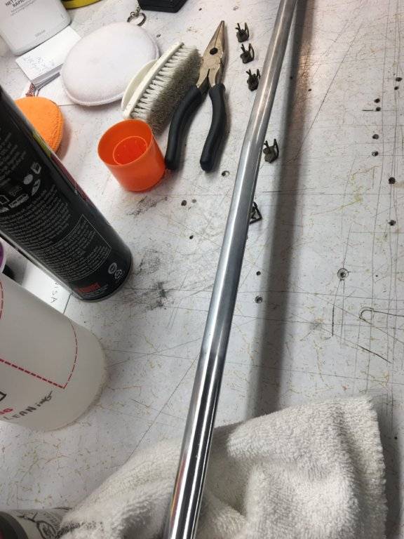

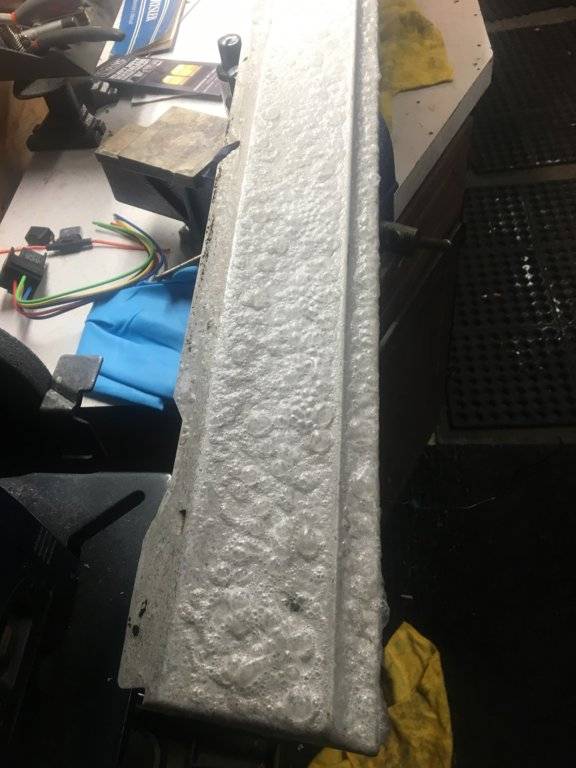

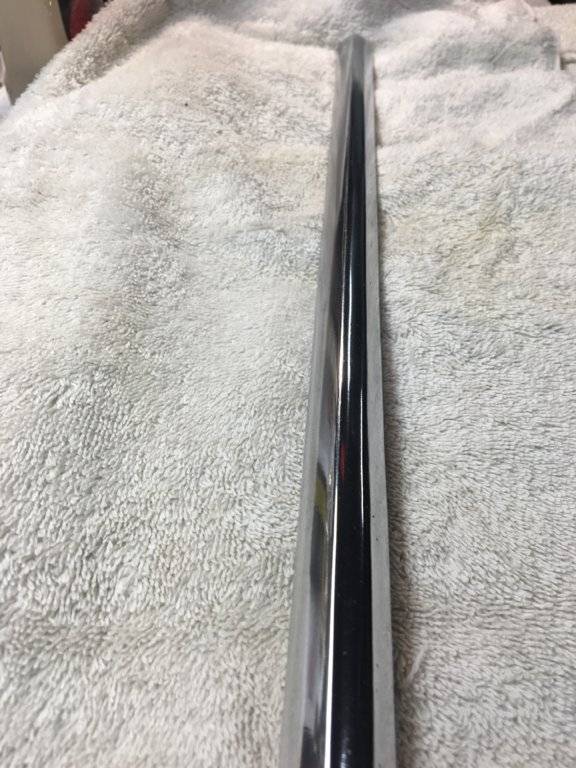

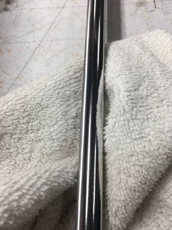

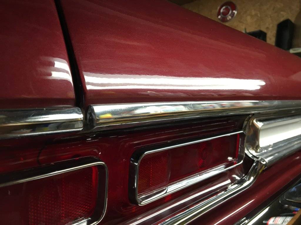

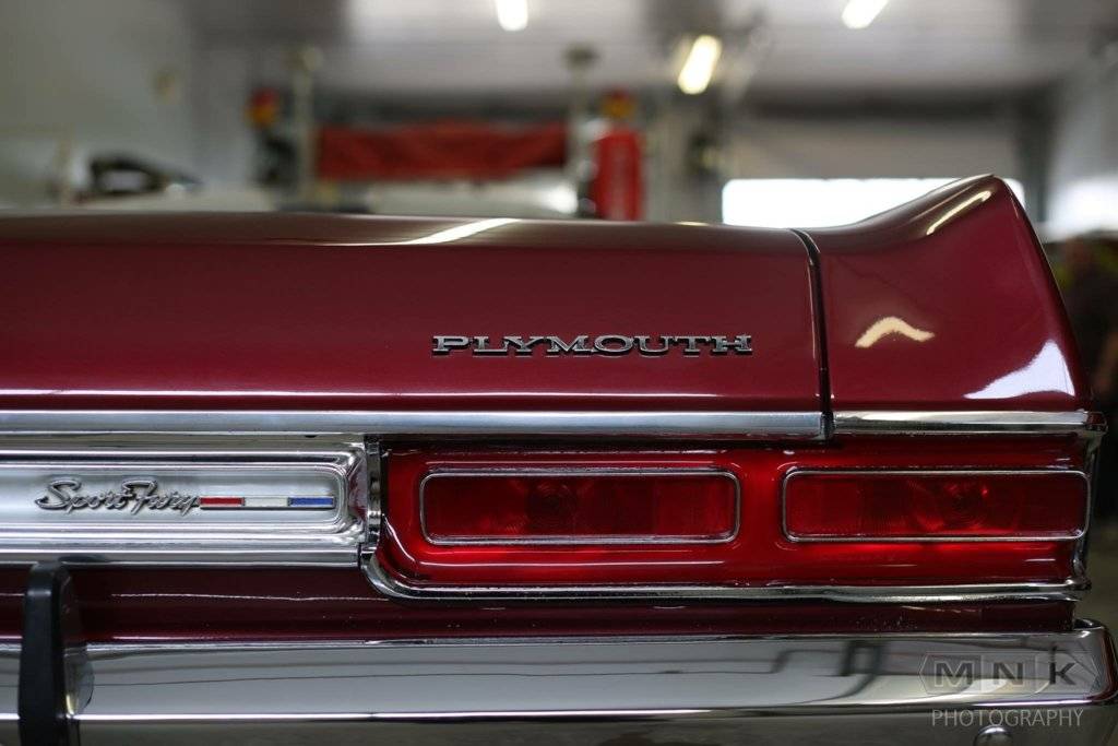

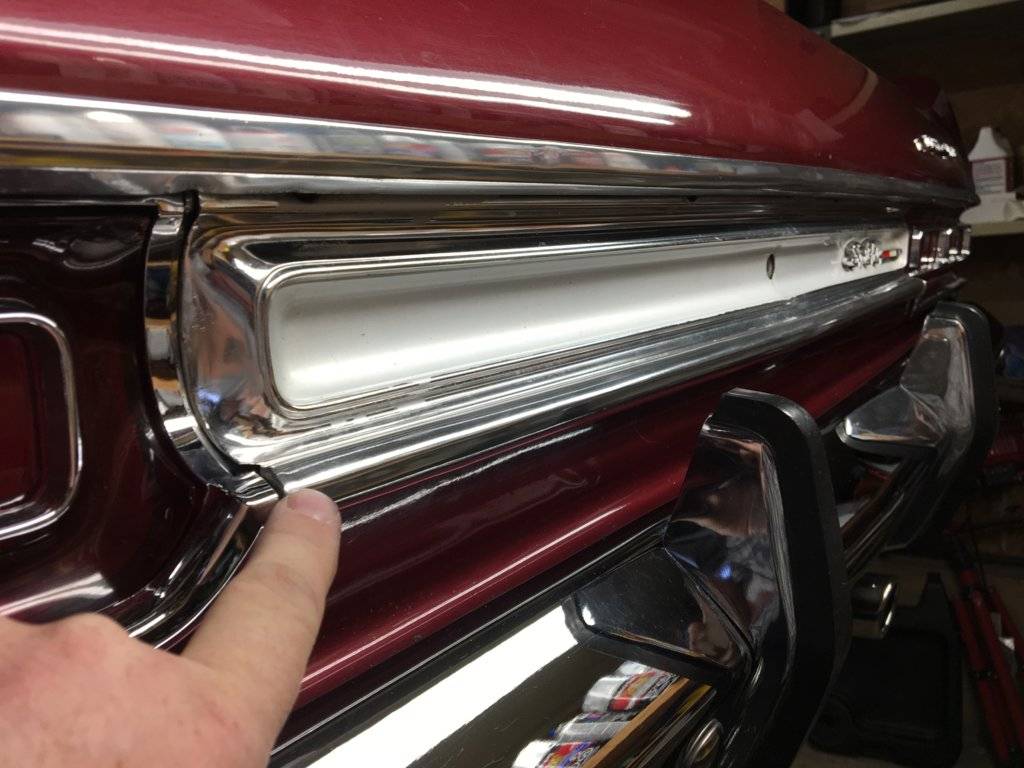

I restored the aluminum trunk trim as well as the tail panel trim last night. I think it turned out well . What do you guys think ?

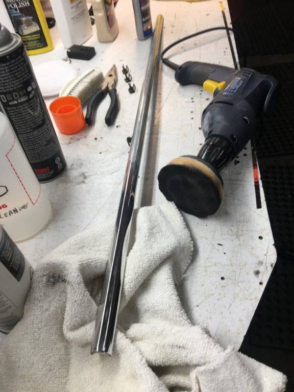

Here is the metal polish and variable speed drill with foam polishing pad I used. It took about 15 minuets to do . It’s the first time I use this product and it works great but you have to have the anodized coating removed from the trim or it will not polish . My final step will be to cover it in the clear 3M film the same stuff you put on the hood of your truck or car to protect it from stone chips. This will stop it from oxidizing and keep it looking great

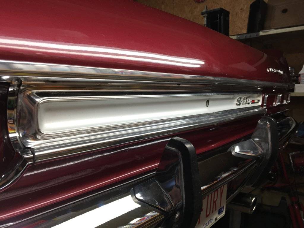

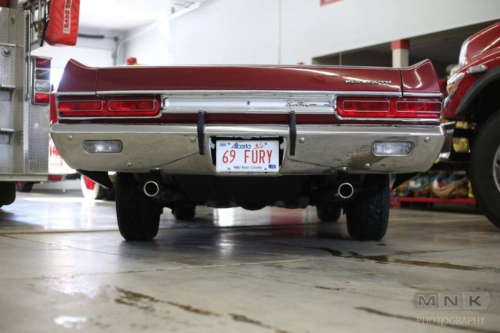

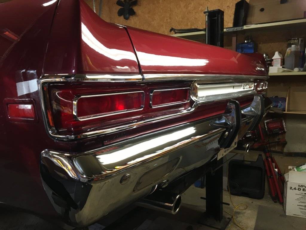

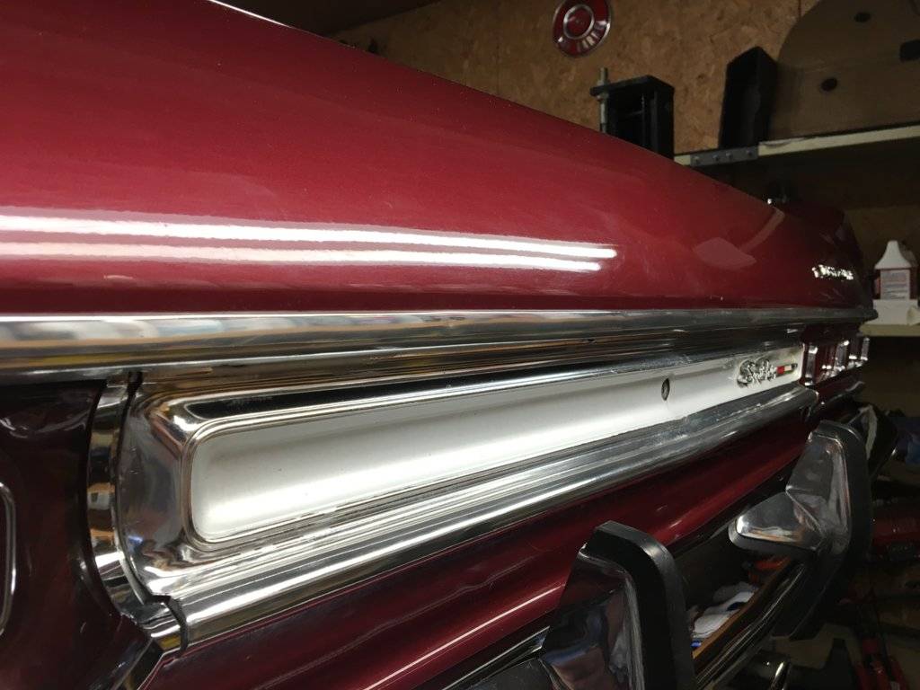

The back end is DONE .compounded and sealed the paint I didn’t have much room to work or take pics I will have better ones later
Beautiful. What is a sizzle wheel?

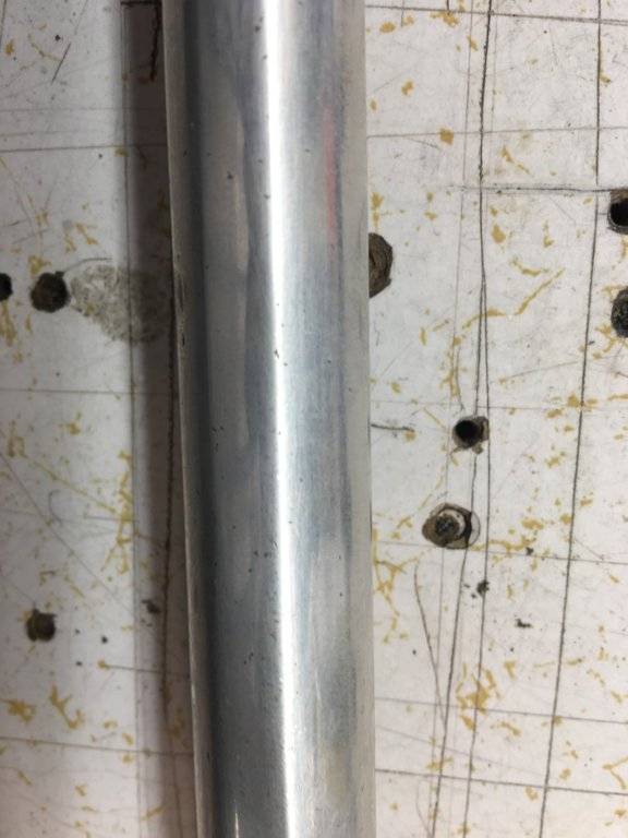

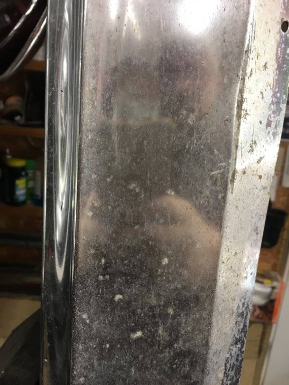

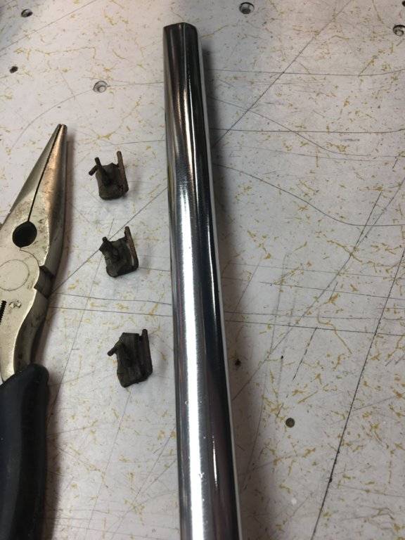

this is the metal buffing set I started with (sizzle wheel) but you need to remove the anodize Coating before you use this so that meant sanding it off. NOW I DO NOT DO THAT : I use easy off oven cleaner to remove anodize coating then polish with surf city garage metal polish. ITS SO EASY ITS CRAZY!!! It saved me 75% of my work time with the same result.
That looks like the kit I bought at Princess Auto :D
yup it is lol.
I learned the hard way now I use easy off oven cleaner and polish with surf city garage all metal polish with a foam pad it’s incredible how good it works. The oven cleaner takes the anodize coating off

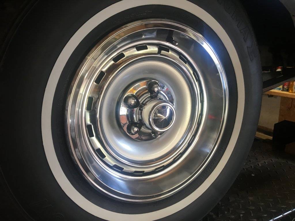

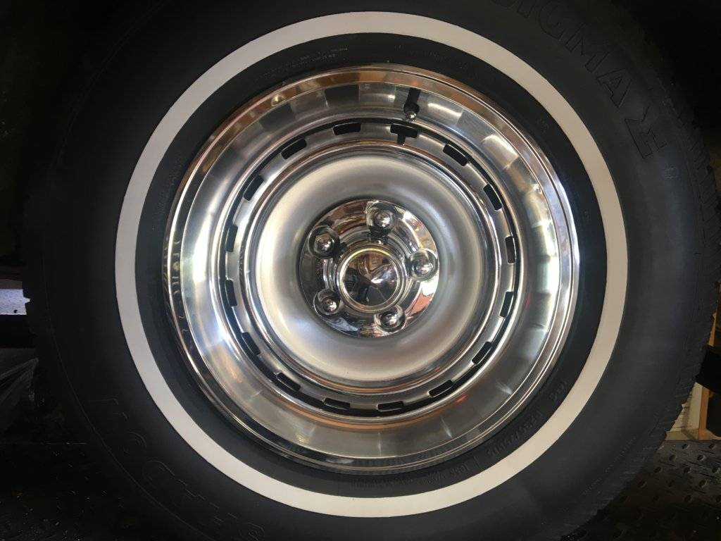

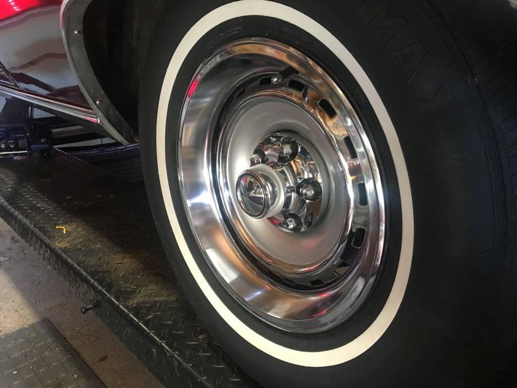

Wheel restoration done . Rim centre painted argent silver and clear coated,chrome centres cleaned polished ,chrome part of rim polished, stainless steel trim rings cleaned and polished .
