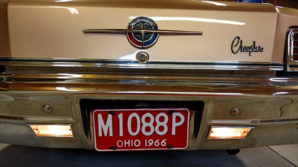

I never had backup lights, I don't drive a lot at night but I realized it also let's people know that you're backing up, so it's a good safety measure too.

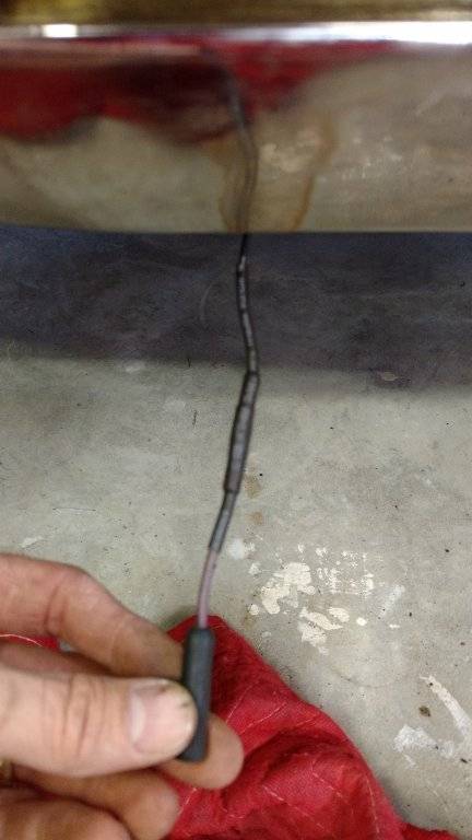

I may not be totally done because the sockets are rusty and I didn't replace them. I was going to take a Dremel tool to them later to try to clean up the rust. They still seem pretty solid. I replaced the hotline and the spring on the one side, they were toast.

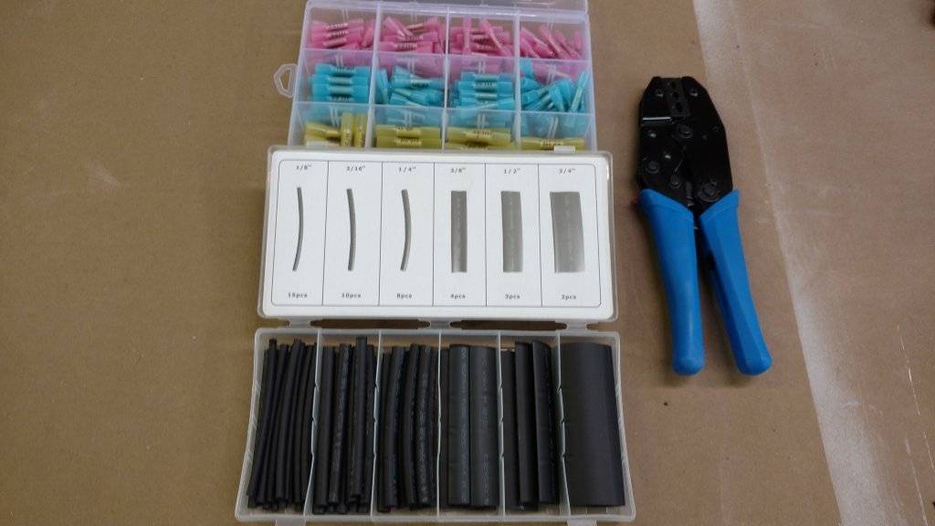

I was finally happy with my electrical repair. I bought a nice crimper, butt connectors with heat shrink, and marine heat shrink to wrap it up tight. If you don't already have these items I would highly recommend, very satisfying to do it right.

Nice one!
Think I am missed something. You had them but they did not work. You didn't have them on the car at all and installed them. Both my 66s have them. That doesn't matter nice job.
On 65s I there is a switch on the column about 6 inches before the firewall. It is adjustable. You may have already look at that.

I gotta mess around with it some more. Need a friend behind the car to watch em. Tried with a mirror but it's kind of a PITA
Basically knew they were crusty and never tried to replace the guts and never even imagined they were still viable.
