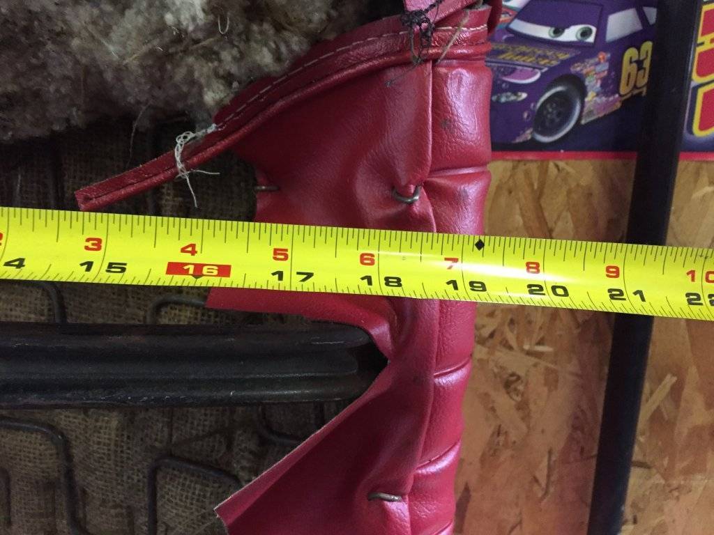

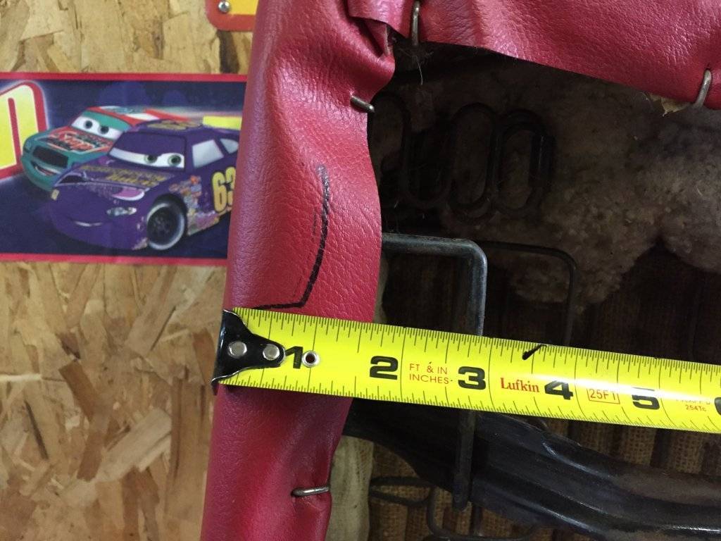

I think Mr Fixit fixed it. Whatever the difference is in the 2 brackets is the amount I am going to try. My measurements say probably 3 inches will be close.
Here's how my seat measures out

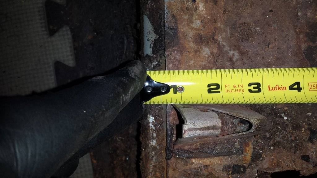

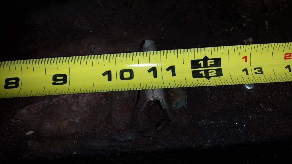

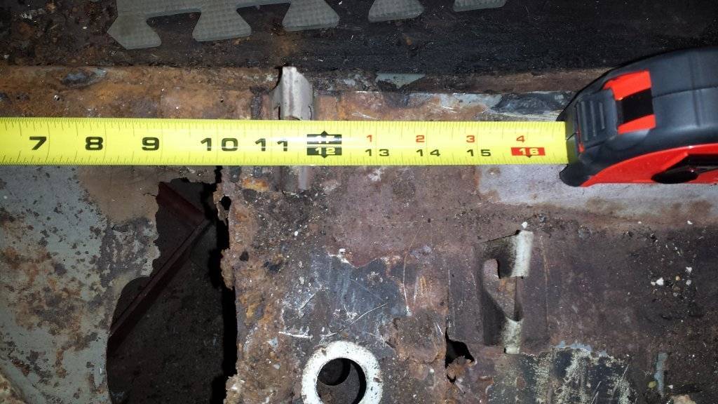

How far back from the floor drop off is your forwardmost bracket?
3/4" from the drop off
11 1/4" from the side on the one side and the other was at 10 3/4" so I attached mine at the 11" mark on the new floor

The difference in the 2 seats is 3 1/4". That was enough to make it not fit the floor right.

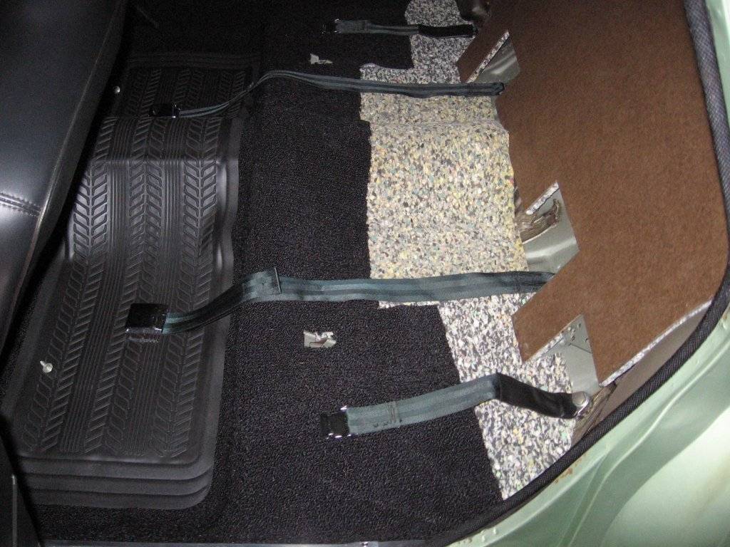

Today I had the back seat out of my 70 300 vert.... and I had to take a pic... I forgot it has two sets of brackets. So it's not a Plodge thing.
So I think we can safely say, there were 2 seat bracket depths on both slabs and fuseys. I'm happy this thread turned into a contribution to the site. Thanks guys!
