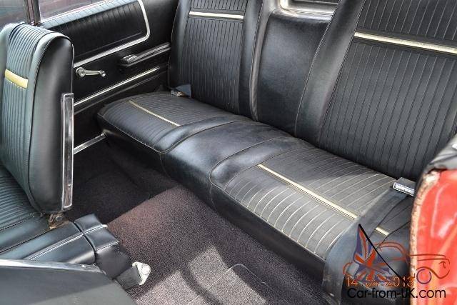

OK so if this is understood right, and looking at Sinbin's pic, 4 doors had the rear most bracket?
FWIW, both of my 4DSD's have one set of hooks in the same location as the pic I posted.
My 2DHT's and convertibles have two sets of hooks.
But they are in different locations dimensionally.
All cars are '67 Newports.
John
I just really studied the pic in the first post.... and it hit me. That's a 4 door seat bottom! The corners are rounded. A 2 door bottom is squarer.
I don't know why I didn't pick up on that.
I agree, good eye Big John!
FWIW on 2 sets of hooks -
I've had probably 15 C's over the years (all 2drs or verts), parted out probably 5-7 (some 4drs), and I don't recall any of them having more than 1 set of seat hooks. And I did in fact have the seats out of most of them at some point. I'm always realizing I don't know everything, but I think I would've noticed more than 1 set of hooks. ????
Just a follow up, it was really simple to weld a small loop on the existing factory seat frame. I extended it back a couple inches, which moved the seat bottom forward, problem solved!
