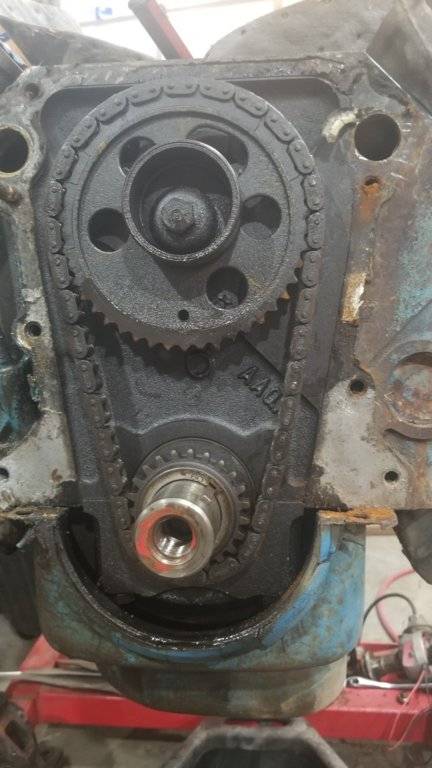

I swear i replaced the chain guess not this is 103000. I think i have too many cars if i dont remember which ones i worked on

Yeah - but you used a stock flat link chain. They will not last. Also that thing looks filthy. Whatever your oil change interval is I'd shorten it by 1/2, or run 15-40 Fleet (diesel) if you don't already.

Rotella 10w30 every 2500 the car had 80000 when i bought it now has 104031
A stock replacement chain and gear set will be fine, they are steel though. I guess your right about not remembering which car got new chain and gears, because it wasn't this one.
