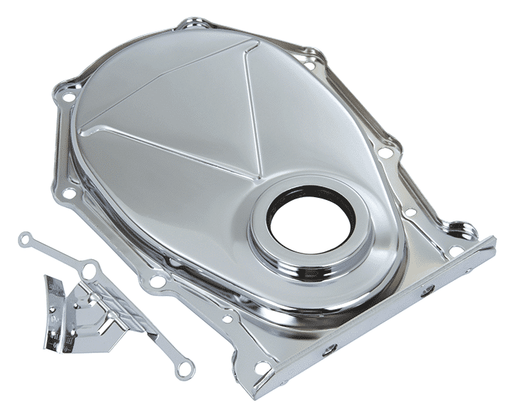

Yes, there are two pan bolts that fasten to the timing cover.
You can see them here on the bottom lip of the timing cover.
You will have to remove those 10 bolts from the timing cover. I would be surprised if they are not easily removed. I would be sure to get a new gasket and crank shaft seal also as long as you have it apart. Not a bad job at all as long as you pay attention to detail such as lining up punch marks.
PS: use some gasket sealer where the cover meets the pan and don't over torque the pan bolts.

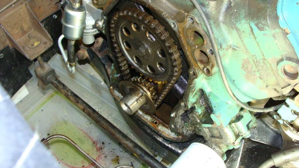

Hi, just did the job, remove everything to this point, they sell a kit of 10 bolts which have the one side to help the bolts stay tight, also, If I had to do it again, I would remove more than just the 2 pan bolts, makes it easier, the bottom cover gasket makes it hard to mate the guide pins. good luck
